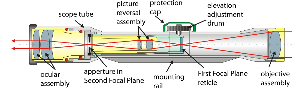

there are. first of all EVERY rifle scope has both a first and second focal plane. the second focal plane is fixed in location and the first is what moves when you adjust focus, parallax, turn your turrets, etc. because of this there is more money spent on the FFP lense than the SFP lense (regardless of where the reticle is placed). now for the reasons for the price difference:
- because one very common use is for indexing the reticle is generally much more accurate and consistent than SFP counterparts. this generally has more to do with overall scope build quality than price though. a $1500 SFP reticle will be just as accurate as a $1500 FFP reticle. however, at lower prices (sub $500) you rarely see FFP scopes because of this reason. an inconsistent FFP scope is much less useful than a SFP one.
- from an optical point of view it is much easier to mount a reticle to a SFP lens than a FFP lens because of optical distortion. the FFP lense creates more distortion than a SFP lense does. because in a FFP scope the lense is mounted right to the lens which creates more distortion it will be much more noticeable. as a result in a FFP scope the actual FFP lense is usually more expensive by necessity.
- a SFP scope is indexed and calibrated for one specific magnification such that a 1MOA adjustment on the turrets is the same as a 1MOA holdover on the reticle. although through its magnification range the two values will remain close there will be a difference (however slight). given that manufacturers make no claims as to the accuracy at any magnifications other than the indexed one this will never be an issue for them. the inherent inaccuracy of 'setting your magnification to 12.7x' will be more than the difference between the turrets and reticle. however, with a FFP scope the turrets and reticle must match throughout the magnification range. this requires tighter tolerances to build around. once again this is mostly at the lower end of the scope spectrum. once you are above $1k for a scope it isnt an issue.
those are the main differences in the cost to build. they perfectly explain why there arent many FFP scopes for $500. however, at higher prices in my opinion the difference in price is mostly contrived. there might still be some small differences in production cost but nothing to warrant a $200-$300 difference as you have in some cases.
i have attached a simplified image to illustrate.
