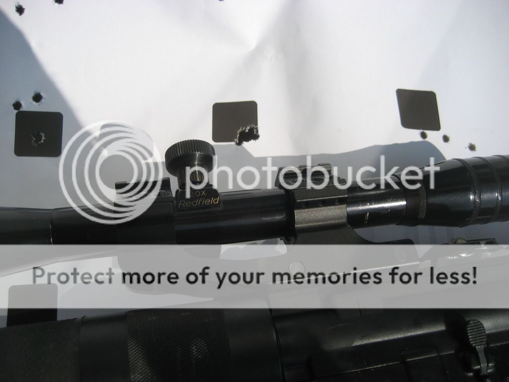

The rifle is shot off sand bags and is topped with a good fixed power 20X scope.

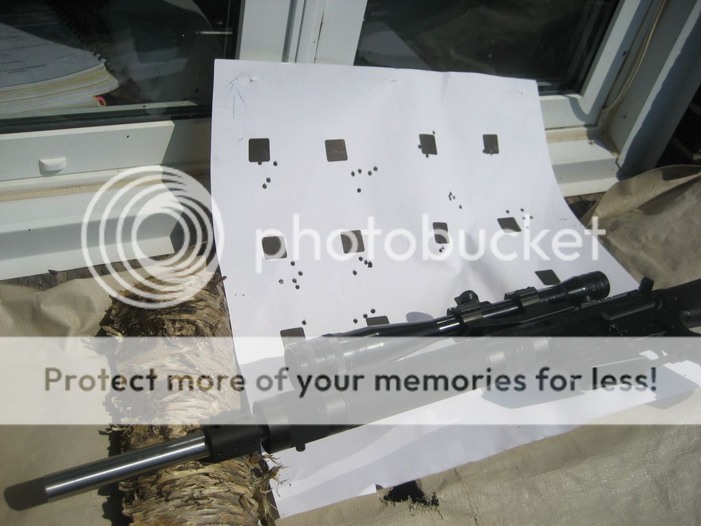

I loaded 10 rounds of each powder charge for the 60HPs, 24.0, 24.5, 25.0 & 25.5. My plan was to shoot 5 of each in two different rifles – the heavy Rock River barrel rifle and a plain Jane Palmetto State Armory 16”. I shot two groups with a rifle, then switched rifles and shot the second rifle while the first cooled. 10 shots made the heavy barrel warm. The ordinary barrel got quite hot.
The 60s were only fair in the heavy barrel rifle, getting better with the hotter loads. The 25.5 N140 groups a hair over 1 inch. Next time out I will try 25.8gr.

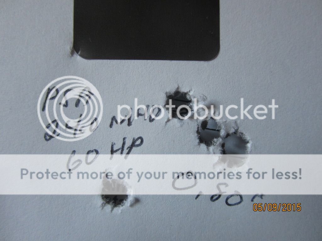

The PSA shot the mild load (24.0 gr) the best. 0.8” is good (I think) for a AR-15. I will try it again, to make sure it was not a fluke. In case I need an accuracy load for the PSA.

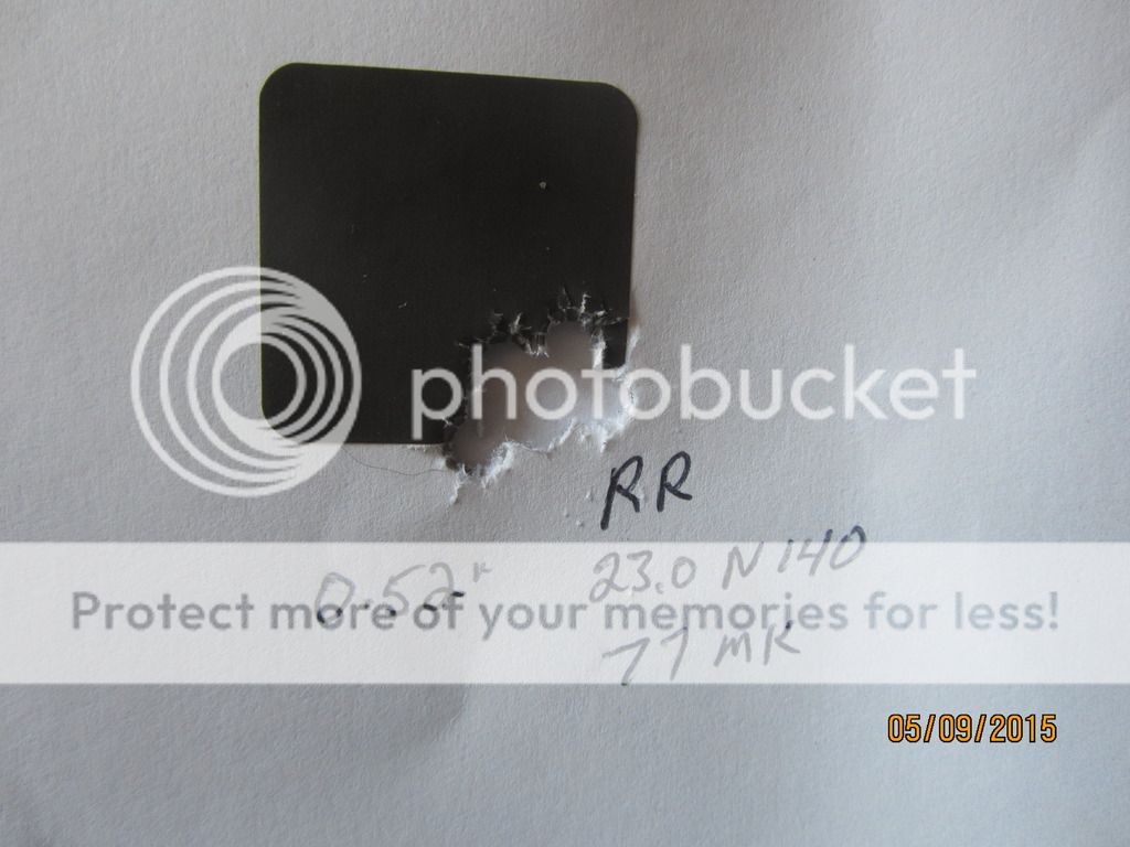

Since I had a big bucket of primed brass (Norinco brass – Remington primers) I loaded 10 rounds with the Sierra 77. 23.0gr of N140 is a fairly hot load, probably round 3,000 fps. This one load of the 77s grouped 0.5” in the heavy barrel. This made my day. At last! A decent group!
I will load larger samples of that load, with additional loads of plus and minus 0.3 gr, to see if this load is real, and if a tweaked version is better.
I have tried this 77gr Sierra match bullet with RL15, 4895 and BLC2, plus several non-canister powders. Groups ran around 1.5”, or more, so 0.5” with N140 sure looks good.

This good group tells me twist is not the issue. I just Chronied that load. Only 2600 fps. Will explore with more powder.
