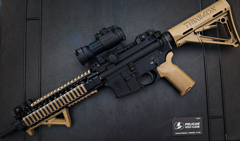

Here's my home built 300BLK upper. Runs like a champ.
- Rainier Arms upper
- Daniel Defense MK18 RIS II rail
- Daniel Defense 10.3" 300BLK 1:8 barrel
- Troy Industries low profile gas block
- Spikes Tactical Melonite gas tube
- Daniel Defense BCG
- Griffin Armament M4SD comp
Lower is running a JP Tuned buffer spring and Spike's ST-T2 buffer
Very pretty!

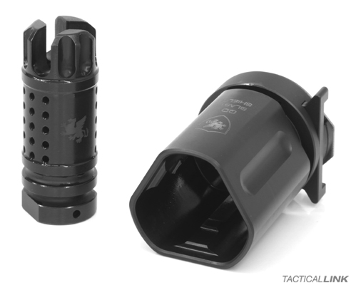

I hear ya with the brake. Check out the Griffin Armament QD Blast shield. If you have a compatible muzzle device, you can attach the shield to make it into a linear comp to direct the blast forward. Supposedly works with both 5.56 and 7.62. I've been meaning to pick one up from CTCS but I keep blowing my $ on other stuff.

I have a Linear convertable to keep the noise down.
dam this thing makes my ears ring with the shroud off.
