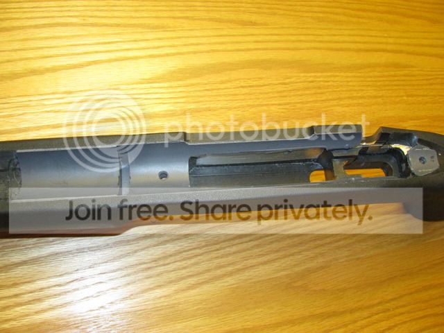

Well I took the time this weekend to glass bed the rifle stock, I used Miles Gilbert Bedrock Glass Bedding kit (picked up at my local Cabelas). There wasn't much space in the stock to apply bedding compound, so I've got lots left over for future use. I've seen some different looking bedding jobs on the net, but for this one I just followed the Instructions that came with the kit.
Here's the area by the recoil lug, I used a marker to show where I wasn't going to remove stock for the bedding compound:
I removed some stock around the action screw area and some stock from where the recoil lug rests against the stock (came across a metal pin in the stock??)
Here I marked out at the back receiver screw where the stock material is going to be removed:
Heres the bedding compound applied to the stock (i used 1:1:1 hardener, resin and micro-balloons):
I then set the rifle into the stock (with release agent) and installed the action screws to align the rifle in the stock and wrapped the action to the stock with surgical tubing from the kit:
After the compound dried I popped the action out of the stock:
There's a bit of a dent in the top right part of the bedding in the pic below due to some clay filler that was protruding out of a crevice in the rifle. Not sure if this is ok the way it is or if I should touch it up with a bit more bedding compound and repeat the procedure..
Nice start but you might want to consider a redo and adding more material. The point of bedding is to ensure support for the entire action within the stock. You have contact points but the sides and most of the lug is unsupported.
The barrel in this project was heavy so I extended the bedding going forward. I would support around the barrel nut regardless.
