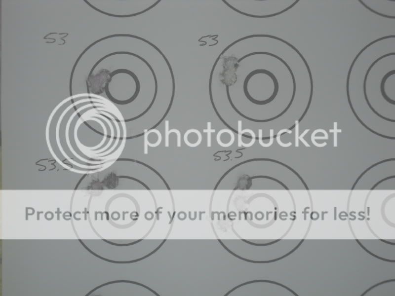

Jerry it is as Rick said. All calibers will get pushed around by the wind. Even the big heavies at the short distances of 100/200 yards. It does not take much wind or a change in direction to make that group in the mid .1's turn into one in the high .2's.
It is of NO use to load develop or practice without the use of windflags. Even a couple will do. When you shoot over them you are giving yourself and your loading an honest effort.
The targets below are an example.
In the first target the left group at 53 clicks shows what can happen when a round is not sized quite right in comparison to the rest of the rounds. The first 2 shots basically stacked themselves on top of one another, The 3rd shot went slightly up and right. Why? The bolt closed harder on the last shot. When I pulled the trigger I was happy with what the flags were showing me. The target to the right of it shows waht happens when you miss a condition with a quick switch in direction just as I was pulling the trigger. The first 2 shots are into the same hole. The last shot went high and slightly right. I was shooting a wind that was coming from about 4:30 and it switched to 6. The shot went with the wind but it ruined a great load development group. These are just 3 shot load development groups. The same would/could happen with 5 shot groups.
The next target shows a 5 shot group on a brand new barrel I threw on my other BR rifle. For break in I fired 1 shot cleaned, fired 2 and cleaned, fired 3 and then shot the 5 shot group in the picture. I found my condition I wanted to shoot in. The first 4 shots went into a .146. I figured I had the wind right for my last shot. Just as I was pulling the trigger a slight pickup and change in angle and the last shot went up and right. It went right where it whould have according to the wind after I fired.
It is amazing how quickly you get accustomed to checking your flag position and tails when a shot goes out of the group to make sure it was the wind and not you. A good group that turned into a big juicy one.
Rick has been at this game longer than I have and has had some pretty good shooting rifles over the years. If anyone knows how wind can hurt you he would know.
Anyone into hand loading and wanting to ring the best out of there rifles NEEDS to shoot over flags. A couple are better than none.
