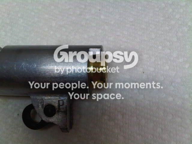

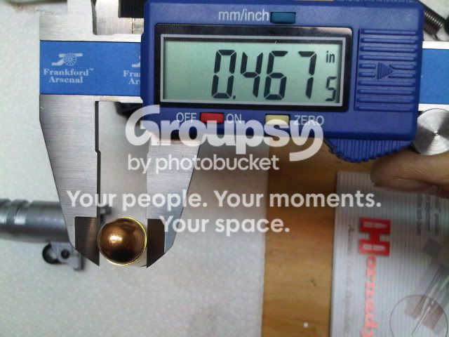

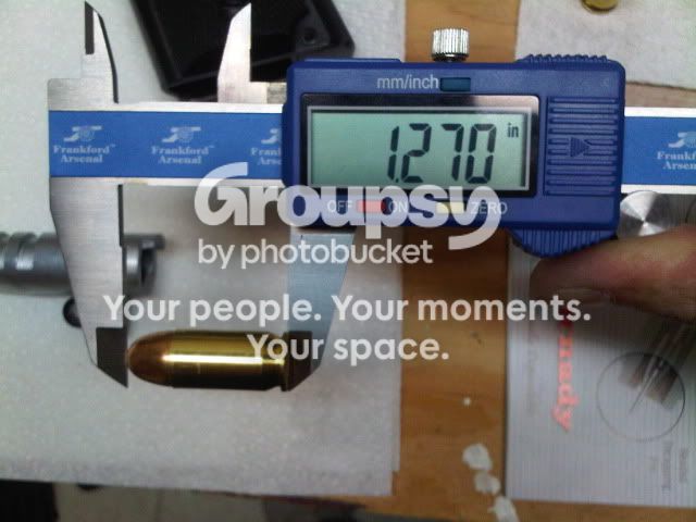

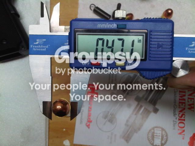

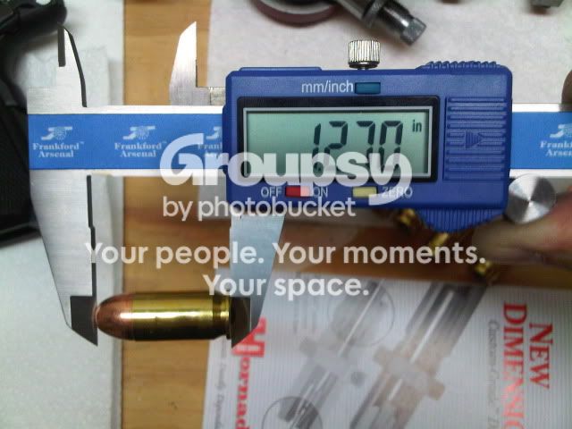

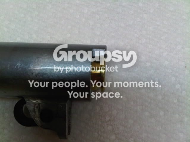

I've taken the barrel out of my 1911 in order to ensure the test rounds are fitting snug. I've got the OAL down but it seems the bullets aren't seating flush. I've included some pictures to show what I mean.
I'm not sure how to correct the dies to fix this problem. Again I don't mind making these squib loads so that once they are to spec I can dial in the power measure and start production.
It seems the front of the round is what's making contact with the barrel. The back can actually rock slightly pivots on the front of the bullet/brass(not sure what's exactly making contact.
I'm assuming the problem lies in my seating die, but like I said, I'm new to this and open to all advice.

Factory Winchester Cartridge:
Homemade Round:

Check the length of your case for OAL. The maximum allowable length is.898" and should be trimmed to .895". The .45ACP headspaces on the mouth of the case. A slight taper crimp should be used. According to the Speer manual the expander ball should not exceed .450" in diameter.

The problem is the Frontier Plated bullet is not the same shape as a real FMJ 230gr bullet. It is fatter at the front (the ogive is closer to the tip) so when seated to the same overall length the bullet is engaging the rifling sooner and not letting it fully chamber. You will probably need a shorter overall length for this bullet in your chamber, starting of course at the minimum load and working from there.

measure case at point where the base of the bullet is for example(.470-.471)
the 45acp was designed for a .010" taper crimp (max or nom crimp)
I try to crimp from .005 .010 (varies a small bit from round to round)
Go too far and you will have problems
in the plated bullets if you crimp too much you can cut or chip off the plating
so the case mouth should be
(.470-.471) - .005 = .466 to (min)
(.470-.471) - .010 = .461 (max) your results might vary

The original poster's crimp diameter could be a little smaller (.469-.471), but I think that the biggest problem here is that the OAL needs to be adjusted to match the different bullet profile. When you are determining your OAL, don't go chasing a particular number, the correct OAL is what fits.
