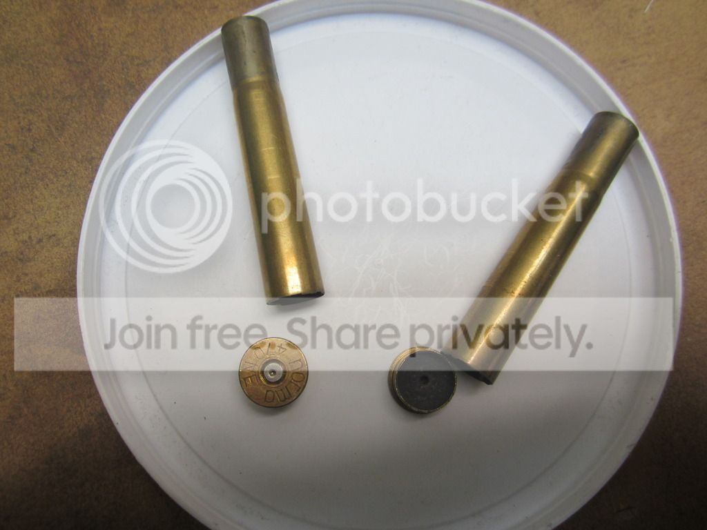

Here's what happens when you think you know everything about something and you start making assumptions..........
This was only the third loading from new and came as a complete surprise to me. I just merrily full length resized them each time, because after all, it is a dangerous game rifle and one doesn't want snug fitting cartridges in a double where you have to fight to get them in and the rifle closed.
HOWEVER.....what I didn't know nor did I bother to research, 'cause after 40 years I know everything there is to know, or so I thought...........is that the factory .470 NE cartridges are formed with the shoulder pushed back significantly from the chamber dimensions. This is intentional and has been done since the days of cordite. It is to make them drop right in the chambers of the double with no interference at all and offers some reduction in pressure in extremely hot climates. Like firing standard factory loads in an AI chamber.
This is all fine and well when one knows this and can adjust their die accordingly, but when one knows everything already and assumes he should full length size for his double, life gets interesting and he gets a "wake up" call after ruining $200 worth of very high priced brass. The dies are made to return the case to original factory cartridge dimensions, not chamber dimensions, which makes a certain amount of sense I guess, but definitely moves the shoulder back more than 1/8" from chamber dimensions. Headspace is not affected obviously, because of the rimmed cartridge.
