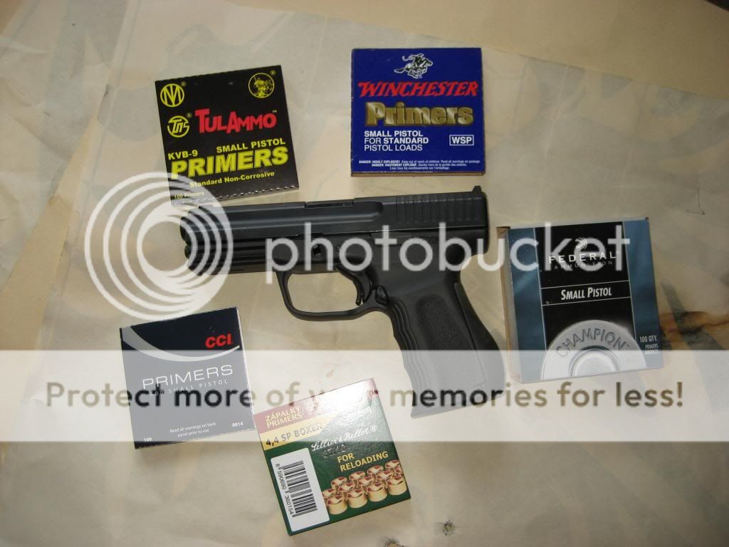

Just got this little guy. gen 2. Canadian version. Barrel is 4" +
The trigger is not the Double Action Only as in the first generation. Complaints were that it was too long and heavy. This trigger is much more like a Glock, but not as good.
The sights are interesting. Instead of putting the sights in adjustable dovetails, the sights slide off easily and can be replaced by others from a sight set included with the gun. The front sight has a choice of three heights (for elevation) and the rear sight has a choice of 5 settings (one centered and two each for left and right). For me and my ammo the low front sight and one notch right is perfect.
The gun groups fairly well, but would never be my choice for competition. Trigger is not good enough.

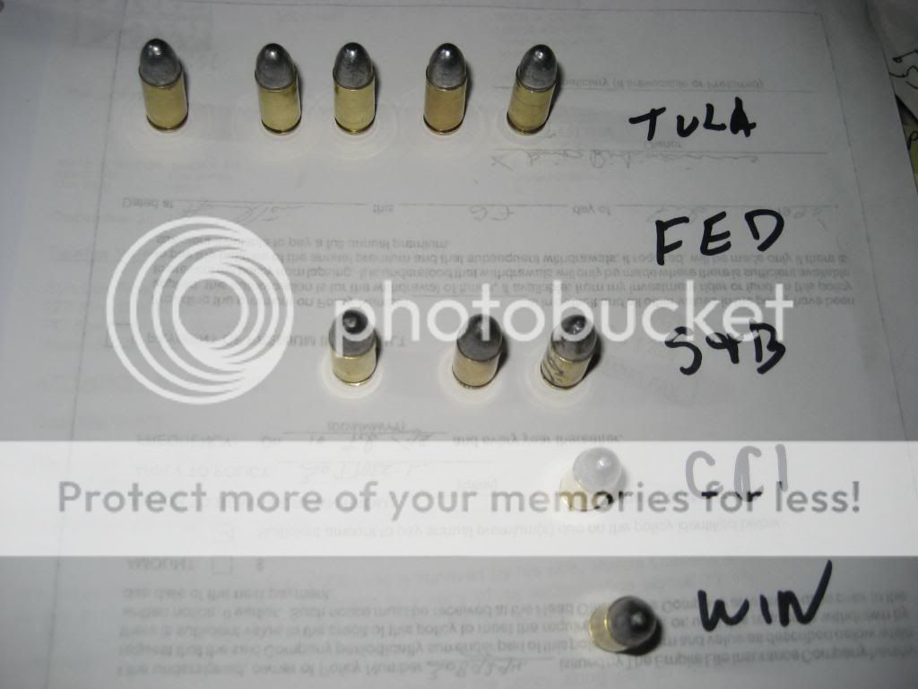

However, the big problem is misfires. Using Tula primers I get 40% misfires. This makes it a perfect gun for testing primer sensitivity. I am loading up some different primers tonight and expect (hope) the Federal to work 100%. I have never used the S&B, so have no idea how they compare to Win and CCI.
