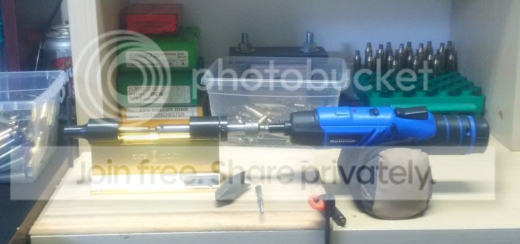

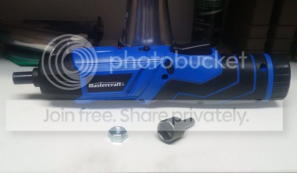

I had the bright idea of starting to prep about 900 Lake City 223 brass and after about trimming 25-30, I was done. Most of this brass had a oal of 1.77 and I swear some felt like they were over 2". heh Anyways in the old thread we were talking about hooking a drill up the trimmer and letting that do the work instead of hand cranking. I dont know what took me so long but I finally went out and got the parts to make it happen. Bought a Mastercraft cordless screwdriver on sale a CndTire awhile back and all I needed to make it work was a 5/16x24 nut and a 1/2 driver socket thingy.
All I can say is that I should of done this a looong time ago. It makes life so much easier. Sometime in the future Ill rig up a better setup but for now it works pretty good.
Setup trimming some brass
The pieces needed
I tried just holding the drill but I liked it resting on this lil bag I had. It slides on the desk nice too. Only negative thing about this setup, is I crazy glued the nut in the socket and its a little off center so theres a little wobble when it turns. No biggie though.

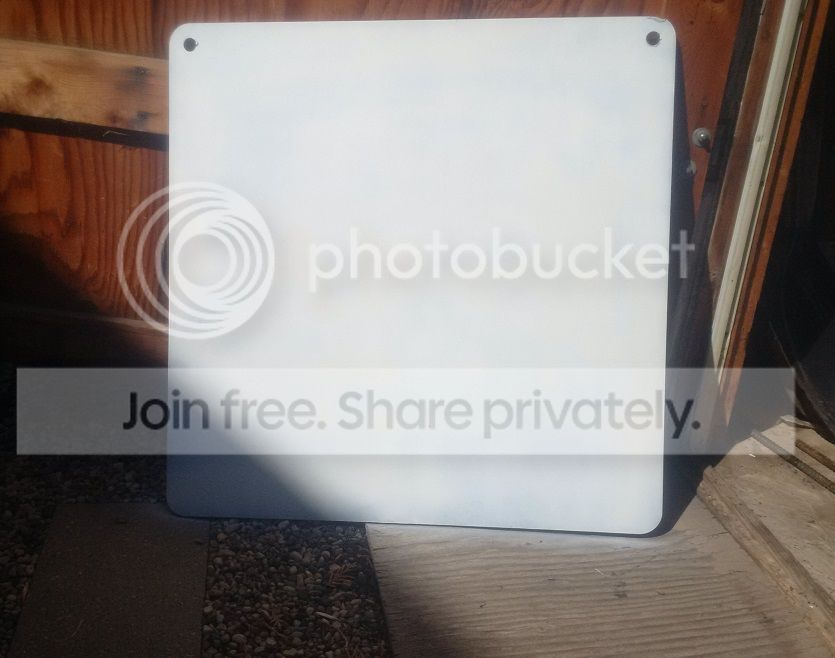

Once I get some new loads done up Ill have to check out my new chunk of steel I got.
I needed a big one because sometimes I cant see my own splashes. If any local guys need something I can get pretty much anything cut up on a plasma table.
The pieces needed
