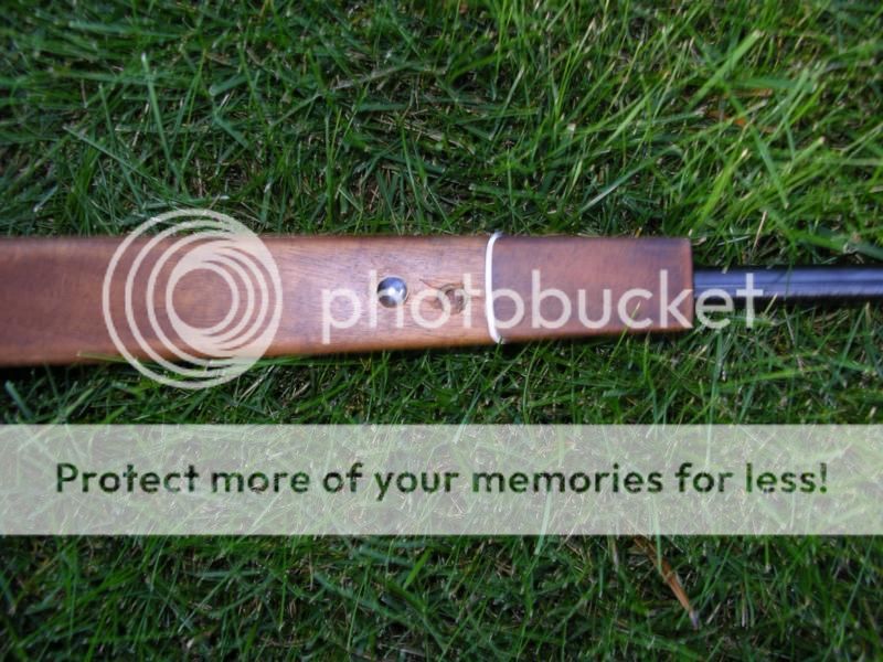

Put together using parts from three different guns, it is one of the most consistent rifles I have ever owned. The barrel is 24 inches long, and came off a Voere that was rebarreled to 358 Norma Mag. The action is a commercial Mauser that had seen better days, and has a Parker-Hale trigger installed.
Bill Leeper installed the barrel, and is no doubt part of the reason it shoots so well. Have never had to adjust the old Redfield 4X on this rifle as long as I have had it! Check it with two shots every Spring before taking it along as a backup rifle on bear hunts, and same again in the Fall.
I bedded it with Marine-Tex into a beater Parker Hale stock that has lots of dings and scratches. Bubba had worked on it somewhere along in its travels. :runaway:
It looks a bit better, after being filled with Acraglass. :dancingbanana:

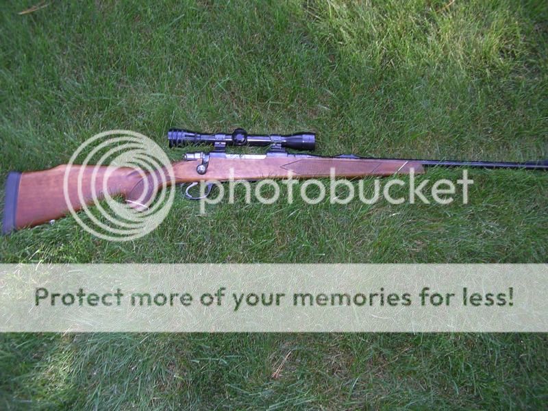

My 9.3x62 is a Frankenrifle. It started life a basic Husqvarna 1951 vintage mauser that I picked up at an auction. I would have lived with the ugly-ish beechwood stock, but it had a major split through the grip. I eventually found a stock for it on ebay in texas, made by a fellow name of Henry Milliron. This was just before they changed the rules on exporting stocks down there.
The trigger guard is a Blackburn. I was having feeding problems with the old one; the rounds would start piling up at the shoulder by the time the last one went in the magazine. The Blackburn is a little wider at the shoulder and solved this problem.
The G&H scope mount was a gun show find. The guy wanted $150 for it, and said people had been complaining about the price all morning. I didn't even quibble.
Final touch was to replace the trigger with a Timney. Then take the box of parts to Ed Von Atzigen in Peterborough to get everything put together.
End result:

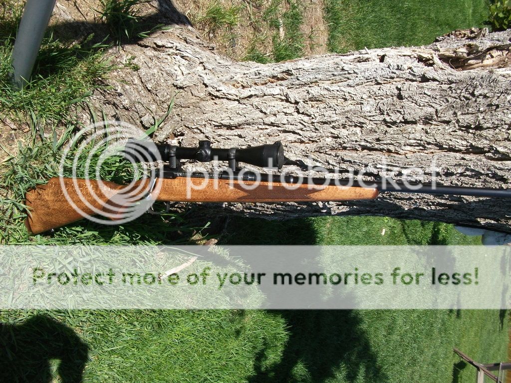

Here is my contribution. 30-06 RCBS improved using a old pre 1940 win model 70 barrel on a 1960 Savage 110 with a late 70s savage beech stock. Nice shooter too.

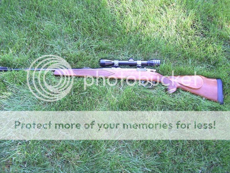

Here's my current and most Frankenstein rifle. M78 Sportsman action which was Rem's cheap M700 rifle before the SPS series. BBl is stainless factory SPS. Stock is a Brown Precision that came off a 358Norma that I owned and sold to a friend. He sold the stock back to me. Scope is a current FXII 4x. Weight as shown is 7lb. I was going to refinish the stock but found some yellow paint under the top coat black and decided to leave it as-is. Kind of a rat gun theme ala rat rod. It's actually a nice little pkg as shown.
