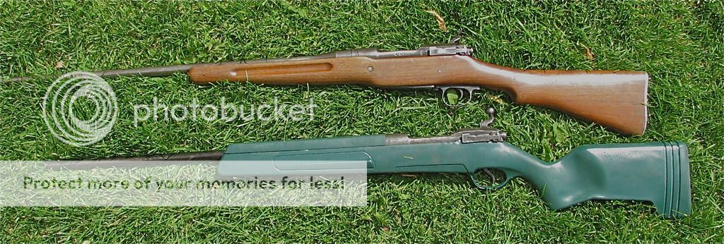

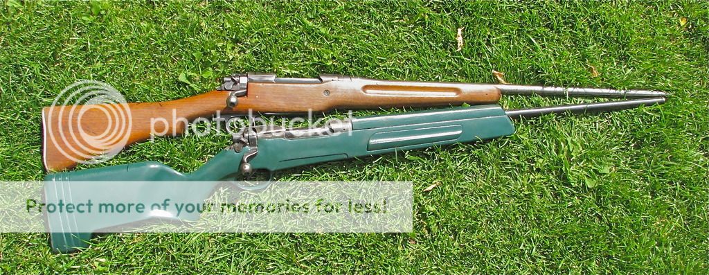

I wonder if I should post a picture of grampas .311-308 norma mag (P-17) and the P-14 in the mauser scout style stock or if this is the wrong thread for that?
That is exactly what this thread is about! Let's see them.

The top is the (303) Norma aka: .311-308 norma mag
The lower one is just a P-14 .303 brit. I bedded it into that stock, am planning on putting a picatinny rail and putting it on the EE to pay for the other .303 I bought, which kinda fits this thread as well:

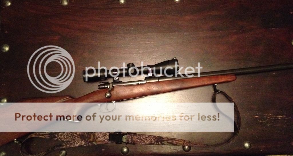

Not exactly a Frankenrifle this is a heavily worked over 98 Mauser re-chambered to 8mm / 06.
The work that went into this is awesome, aside from the outrageous stock, the metalwork has a beautiful rich blue and virtually all lettering and numbers are polished off.
Wood to metal fit is nothing short of perfect and the rifle is very comfortable to shoot despite the shaping of the stock.
I would dearly like to know who did all the work on this piece as the seller, fellow CGNer and dear friend ( H4831 ) knew very little about it.
So if anyone out there knows of the builder please chip in...
