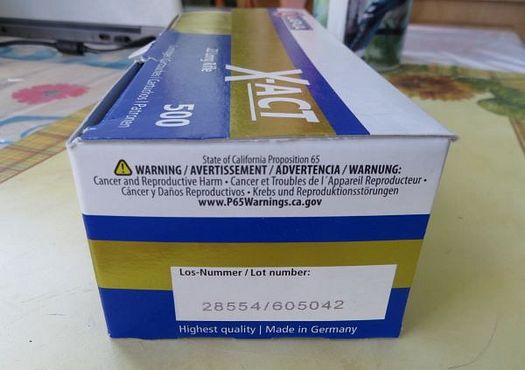

Having said that, the one lot of Lapua X-Act I have is very inconsistent on target. Over the chronograph with two different rifles, two boxes showed extreme spreads over 50 fps, another at 70 fps. SD figures are in the double digits. The smallest ES for a box of this lot was 33 fps with an SD of 8 fps. This is Lapua X-Act lot 28554/605042.
I don't know what experience other shooters in Canada have had with X-Act. Generally, good lots shoot well across many rifles, while poor ones don't. Unfortunately, there have been a few posters reporting disappointing results. Of course, any grade of ammo can have poorly performing lots. While there is a very limited and inconclusive set of anecdotal evidence, it makes me wonder if Canada is getting more than a fair share of poor lots of X-Act (or even Midas +).
It would be interesting to learn what other shooters in Canada can report about the performance of different lots of X-Act.
