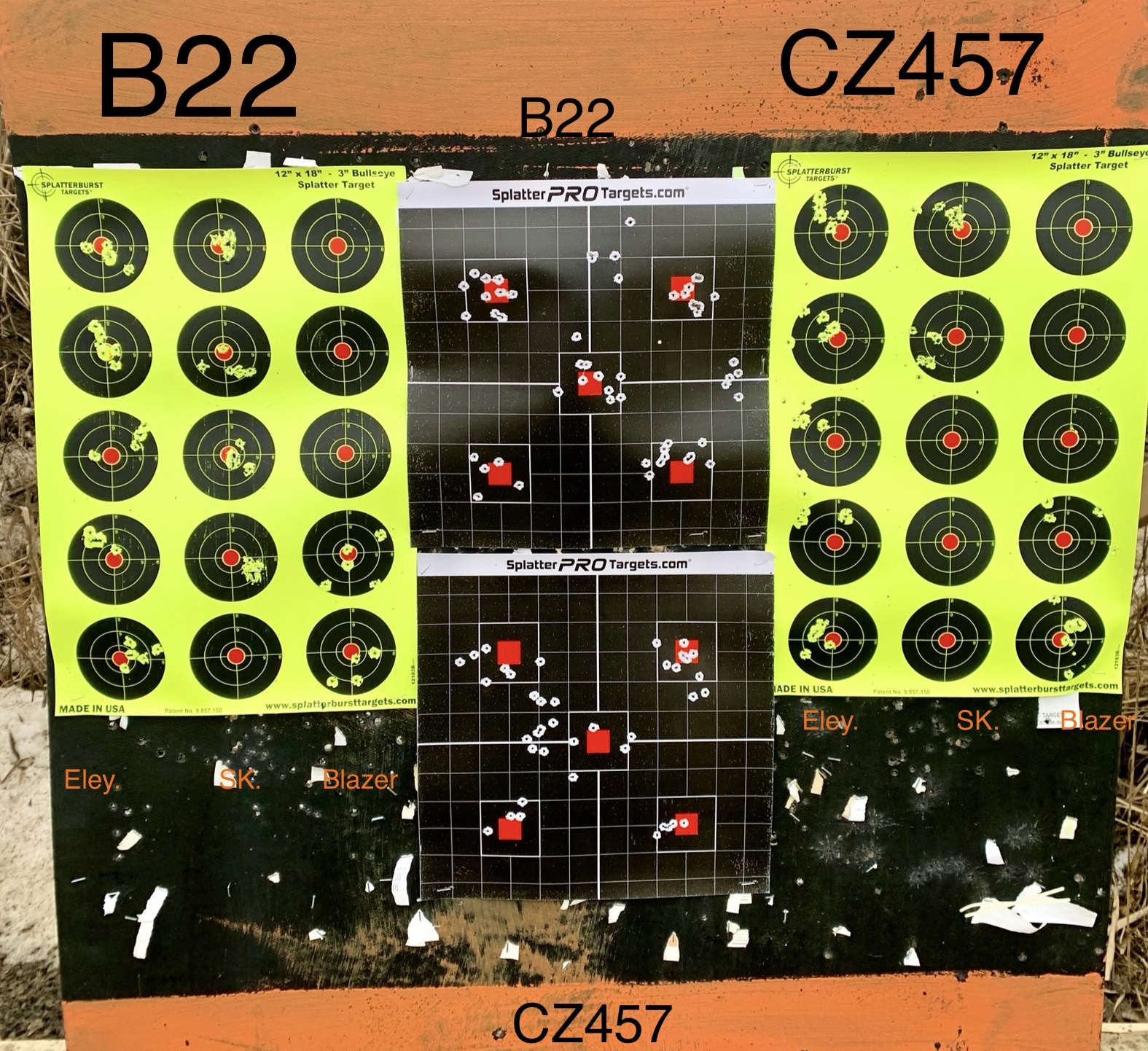

Went to the range today and shot a mix of Eley Contact, SK Long range match and CCI blazer at 100yards.
Shot 10 Fowler/Zeroing shots between each type of ammo. I then shot at least 2 5 shot group's. And I did this with two different rifles. 1st was a Savage B22FVSS. Second was a CZ457 Canadian.
Conditions were pretty ideal for a January day with little to no wind and not too cold of temps 1*C.
As usual the SK and Eley both shot well for me. But my best groups from both rifles came from the SK. The B22 shooting the SK had 3 outa 4 groups at or under an inch. The eley was around 1.5” from the B22. In the CZ 457 both eley and Sk had groups in around the 1.5”. As one would expect the blazer shot worst with both rifles blowing groups out to 2-2.5”.
