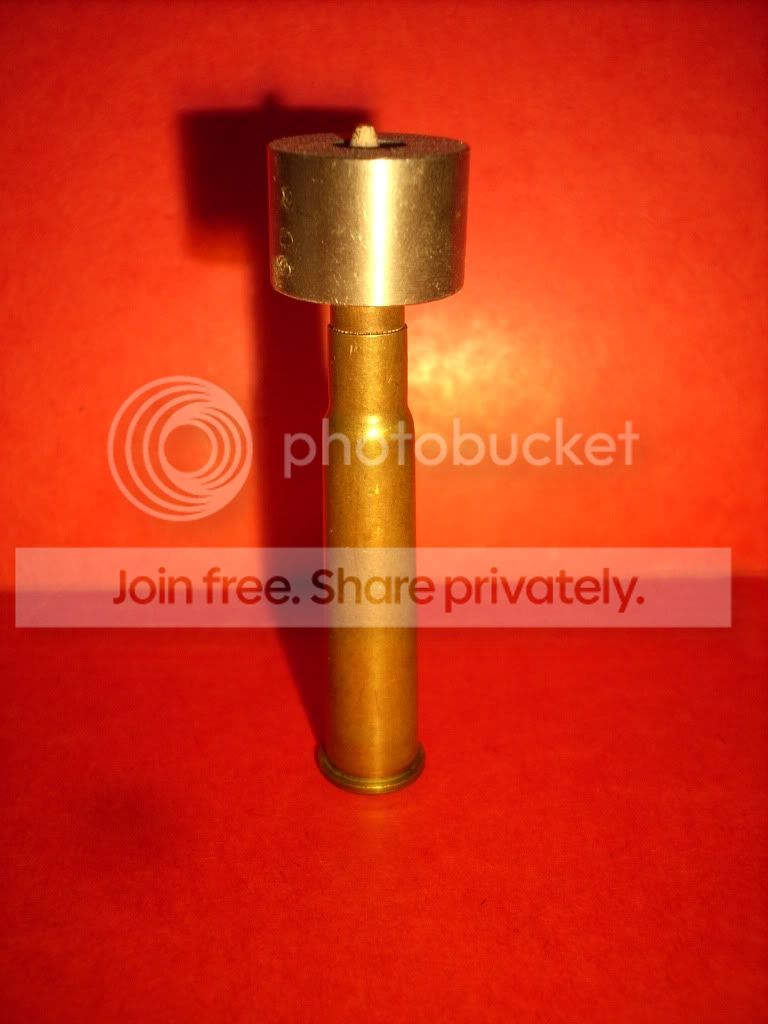

This is a useful tool. The hole is bore diameter, so the ring sits on the bullet ogive. You can measure from case base to top of the ring for measurements to compare OAL to a standard.
