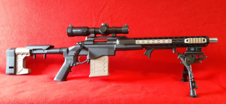

Even with the correct bolt face the factory 700 BLK guns have the extractor clocked in a different position than the 223/222/17 guns. The same problem presents itself when trying to make a fireball conversionIm doin the same thing now too...... Im putting together a short barrel 300BLK....
300BLK is a fun rd to play with in a bolt gun...especially if limited to ~ 100yds
As cheap as it gets to reload...small primers and fawkall powder...pretty much free brass always around....and nice big 30cal holes to see/hear
Putting it in a MDT folder and mounting a reverse fake can to freak out the fudds![]()
Try it, if you have ejection issues probably the cause. Remington wouldn’t change the extractor clocking for no reason.So my Rem 700 short action 223 bolt wont work with the aftermarket 300blk barrel I have ?
