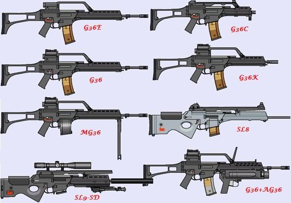

Can someone help me by posting pics of the orig G36 with various barrel lengths so I can get some feedback on profiles and lengths desired.
My goal is to make 10/22 barrels that will mimic the real thing - or at least what you see forend forward. Threading for muzzle attachments are a given but I can also do fluting.
So a fluted heavy shorty is possible. Or, a M4 type profile with grenade launcher notch - or whatever the orig has/had. I am unfamiliar with this rig.
Swamped with holidays and year end stuff so please let me see some pics and info so we can get new profiles entered into the CNC machine.
Jerry,
A google search turned up this:
I don't know what the specs are on the various models, though. Keep in mind that the Archangel version is probably not 100% scale, anyway, so whatever barrels you get in will need to be adjusted for the 10/22 receiver position and stock size.
Personally, I want a K or C model replica.
Edit: Wikipedia gives barrel lengths for some of the models, http://en.wikipedia.org/wiki/Heckler_and_Koch_G36
If the stock actually folds on the Archangel version we will have a problem, as both the K and C models are less than 26" when folded.
Mark
Thanks Mark, The pics showed that the stock folded and if so, that will limit the barrel right now.
My guess is that the G 36 and E model has a 14.5/16" type barrel. The K is your 11" or thereabouts.

Jerry,
we can also permanently pin the folding stock in order to get the G36c look we all want.
I know I would not want a long barrel if I was to get that stock.
It also looks from the picture that there is 4 slots cut up front, which means G36k clones but no G36c. Hopefully there will be a G36c stock.
According to the wiki page I posted, the E model barrel is 18.9", the K is 12.5" and the C is 9". Overall lengths are 39.3" for the E, 33.9" for the K and 28.3" for the C, all with the stock extended.

Well, by pinning the stock, the K version sure looking ###y. That would be a no brainer barrel to produce. The scale of the stock looks pretty close to orig so 12ish" barrel could be perfect.
Looks like K forend with C sight rail.
We are discussing an M4 'ish profile for the Carbine/AR style kit. Will do some measuring over the holidays.

Thanks for all the pics and measurements. We will have to wait for the kits to come to get a true measurement but 12" seems to be about right. However, the forend on the kit is much longer.
A barrel with a 0.70" muzzle and no taper should look right for the part.
