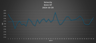

I had always just assumed that the skew would be 0. So now I'll get some more chronograph data (from my brand-new Labradar LX) and start charting and calculating. Unless you already have enough data to share?
So here's a chart of the data:
A histogram that I had hoped would be smoother:
Here are the stats:
Mean:
2771.642​
SD:
13.12501​
Skew:
0.071484​
Kurtosis:
-0.10632​
And here's the raw data: https://nextcloud-fi.webo.hosting/s/Fqw8ZQAQnAZcTN2
It got warmer as the day went on (from about 5C to 22C), and this affected velocity as shown in the trend line.
Visually, the histogram is quite lumpy, suggesting more data required. While there is a mildly positive skew, it isn't significant.
PS: numbers from my newly-acquired LabRadar LX.
PPS: shot #1 was a cold barrel
