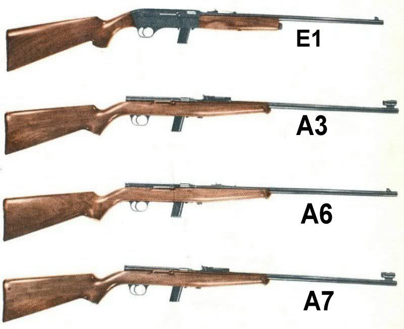

Gevarm had FOUR different .22rf models for export. None were marked with the Model designated. Which one of the four does yours most resemble?

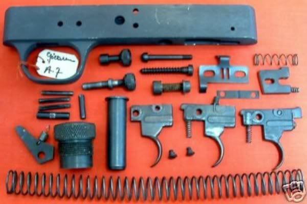

And, I have a pile of various Gevarm parts for the A7 which I recently purchased from a guy in France. I needed only the rear sight for my gun, so the rest of the parts are available if you see anything in the photo you might need. Sorry, but no stock
I still need to find an A3 and an A6 to have 'em all... :D
Best regards ~ ~ ~ mauser
Mine is the E1. Thanks I had no idea what model mine was, and I had no idea they made 4 different ones, I've only ever seen 2 different models.

There are 2 pins that go throught the body of mine that hold in the trigger group, Mine are not factory,(i think they are just bits of metal someone had lying around after they lost the original ones) any idea how hard they are to come by?
Tks for the info, keep it coming!
Pins are a pretty common comodity wherever you may live. If all else fails you can check with a local watchmaker, or car repair joint and usually find a pin that will work - IF you don't have a gunsmith close.
As for mags, back in the days of yore, S.I.R. had both the 8-rd and 20-rd mags for sale, they both were WAY less than $10. Now you're lucky (down here) to find an 8-rd for $85, and last time I sold a surplus 20-rd the buyer offered $175. By the way, the E1 is the ONLY one the 20-rd was designed for.
To use a 20-rd mag in any other model requires drastically changing the mag port - results is a non-original collector's item.

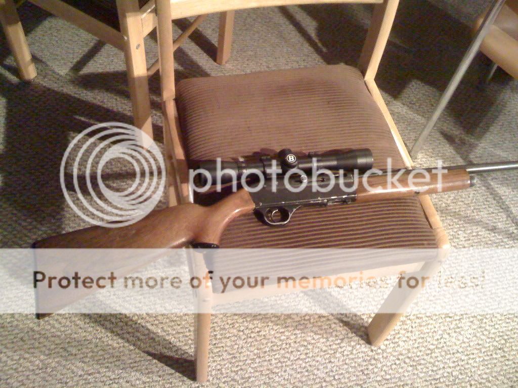

MY baby, beat but not broken...

Here they are, the pics I promissed!
Gevarm E1 (thanks Mauser)
And here is the abortion I called a thumbhole stock, funny thing is It actually worked fairly well, untill I decided to fiberglass it.... I lost interest when I realized you really cant make a silk purse out of a sows ear!!;) l0l!

Like they say, notsorichguy, beauty is in the eye of the beholder. IMHO you were attempting to make a sow's ear out of a silk purse! You've got a great little gun just the way she is. Don't even try to improve on it. Nice pictures, by the way...
