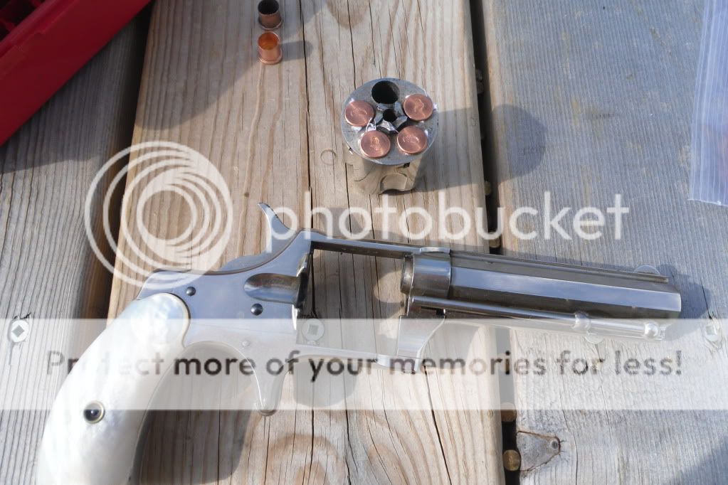

Okay, this was not a blackpowder workaround.

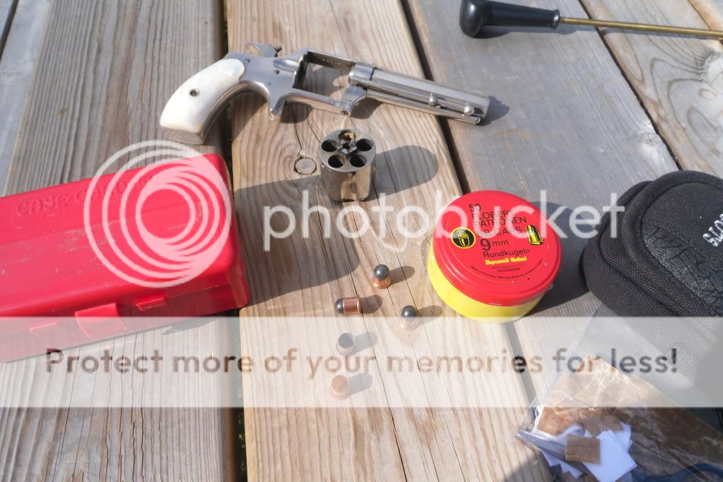

I decided to try smokeless instead. Using these Dynamit Nobel 9mm acorn BB caps, I pried up each BB with a pair of needlenose pliers.
Then measured out 2.0 grains of Red Dot powder for each cartridge. Putting the powder in and keeping it there was kind of tricky as one cannot get a firm grasp on each tiny 9mm case. I pushed the empty case into the bottom of a standard funnel, that all of us reloaders are well acquainted with. Then used a foamy earplug to hold it in place and poured the measured charge into the case. Carefully I lowered each case ensuring my fingertips grasped it before it could fall out spilling the tiny charge.
Then it was a simple matter of replacing each "BB cap" and half-ass crimping it using the same pliers to gently tap the soft lead ball back into place.
The next matter to deal with was reliable ignition. As this was a constant headache before. To resolve this I took .22 calibre cleaning patches, and these cotton wipes just over one half inch by one half inch, were perfectly fitting to place over each charge hole of the cylinder and then seat a newly 'handloaded' round into place.
This kept the loose fitting 9mm rimfire case from moving around and the hammer could strike it better, without loosing steam, so to speak.
