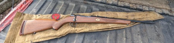

I have my dad’s hold Danzig “sporterized” 8x57 and it is a great cartridge! Got a moose a few years back 200gn accubond going 2550fps( if I recall correctly) shooting moa. That rifle is light elegant accurate and legal for everything up here even bison! I might try to find an other one some day!! Or maybe a double or a combo in the rimmed version of the round! 40FF68E5-C2ED-462D-A407-743B71D593D2.jpeg
^^^ what year?^^^
My 1918 Danzig. Was also an abused rifle when I got it.
No idea of the year,serial number 8102. I wouldn’t say it was abused, but I did refinish the stock cause it had varnish on it and didn’t like it! The barrel is a bit dark but she still shoots good enough for hunting. I have an old tasco 4x on it that seems to old up well for the age!

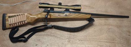

I got an old k98 in a pretty nice looking sporter stock with montecarlo cheek rest from intersurplus. No cracks or anything, and looks bedded, adjustable trigger. Reciever even has a reich eagle on it still haha. Shoots 170grn interlock handloads at 2660fps Avg. . 200y. Fixed 4x scope. Upper 3 are from my bore site in. Bull is all dialed. Not bad for an old dog. Also have a nice husky m96 with a 2.5x setup for Bush wacking in the valley around here.
Now I have a 6.5x55, 7x57 and 8x57. My bsa model D in .303 is the odd man out.
