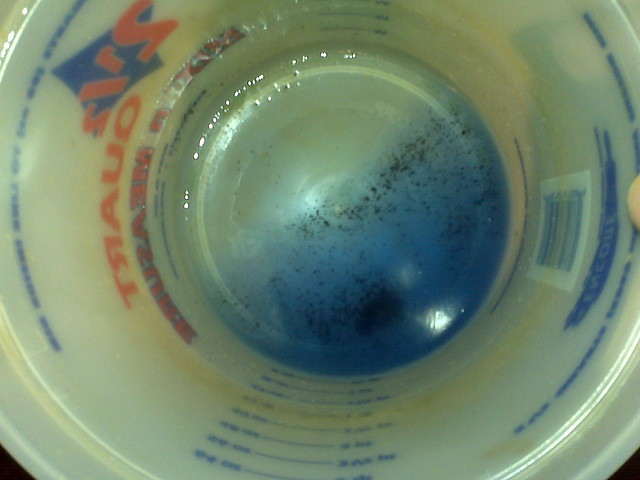

im gonna find directions to make one just because im curious of the crap thats gonna come out, haha. is this something i can do in the house or will it smell like im smelting something in the basement and attract the attention of my wife?

Great advice. I would just ad that a 9 volt battery or an old 6 volt flashlight battery (the big square one ) will work in place of the charger. Make sure you have the polarity correct.
