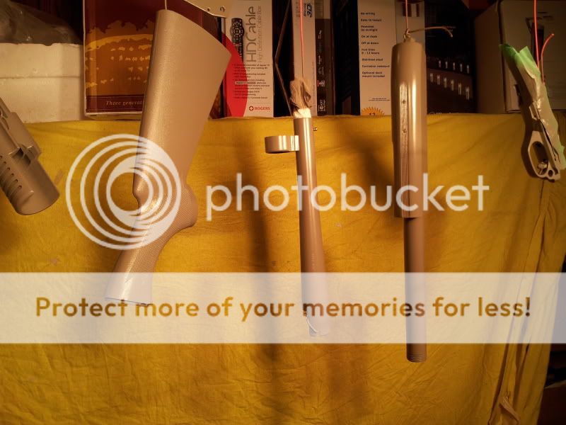

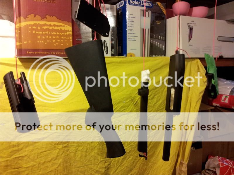

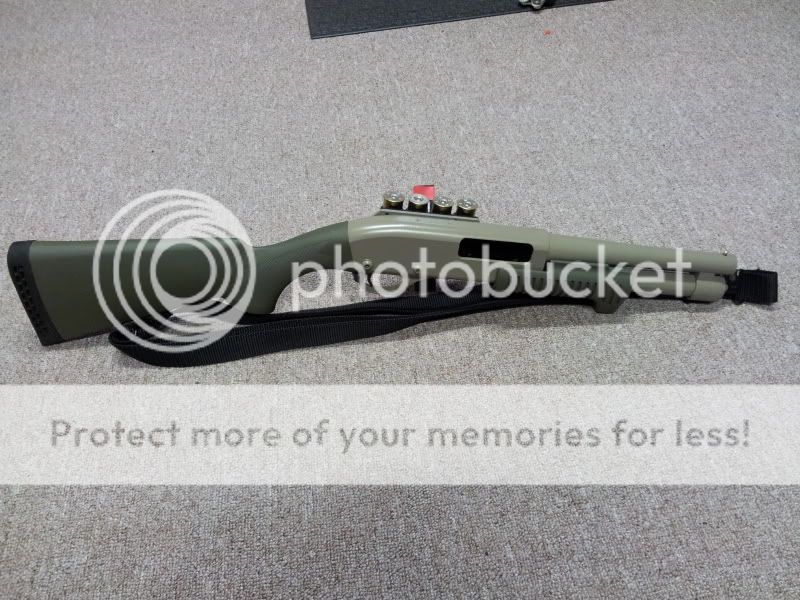

So I took a scratched up 8.5" Grizz and decided to make it green 'n stuff :) Since I was painting it, I took the opportunity to sand down all the sharp/rough edges i.e. the ejection port.
Enjoy
Prepping
A couple of coats later
Finished product

To answer all the questions, I ordered the kit from Lauer in the states. Great service but the shipping and brokerage is outrageous. Each kit is about $30 and it costs $30 to ship, in addition UPS will ding you $15 for brokerage.
As far as the application is concerned, no special treatment at all. Use the provided stripper spray and paint away. I chose the kit that comes with the propellant bottle as I don't own an airbrush kit.
Use in well ventilated area, this stuff stinks.

Well ventilated is right. This is very strong stuff. As stated you can get the spray kit (like a spray can) or just the paint, but you will need a spray gun and compressor in that case. Or you could also get a hobby spray gun that uses cans of propellant. Either way Duracoat is worth the money when you see the results.
