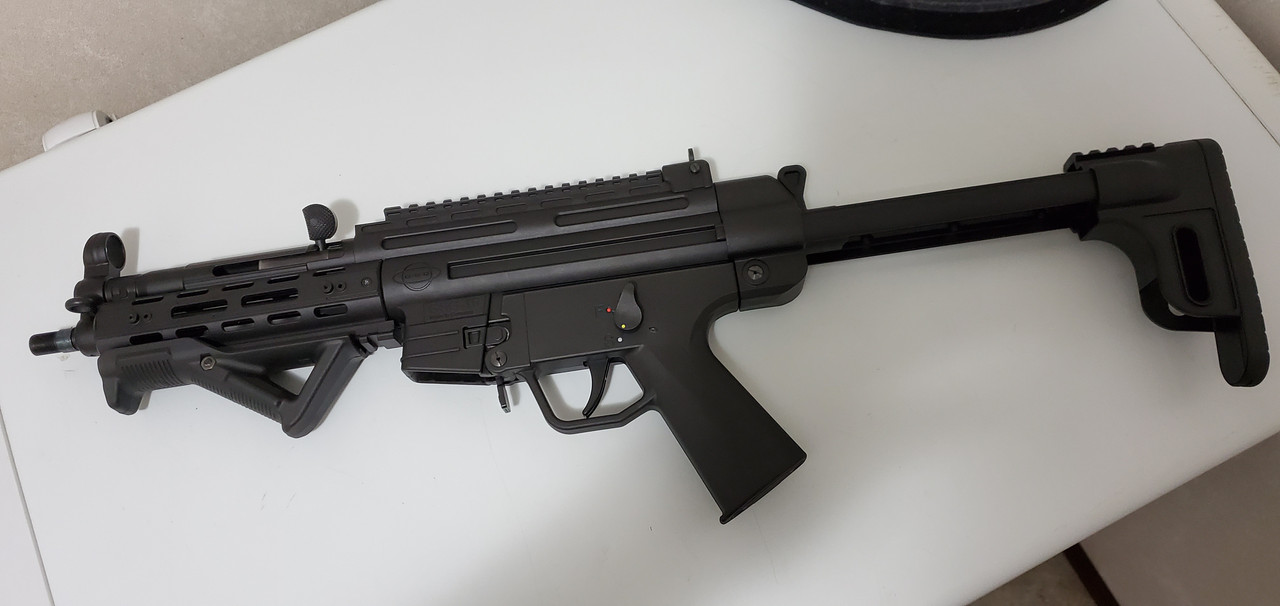

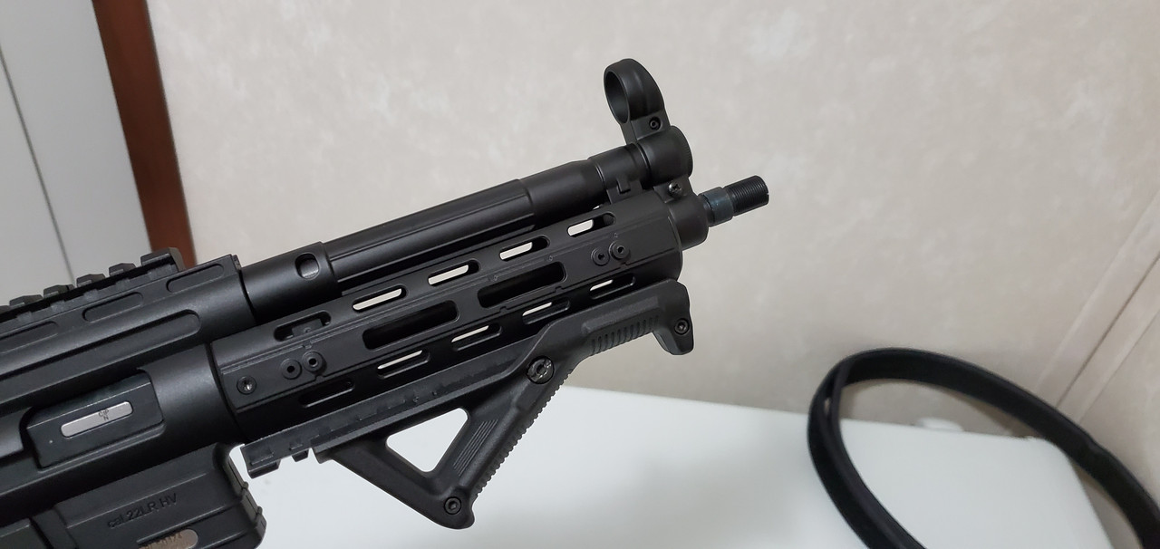

Oh man, I'd love to see pics of your rifle with the new stock and the G&P forend. I have a full CYMA stock for mine, and I debated between the G&P flashlight forend and the A4 style forend. I caved on the A4 style (stock pic below), but I'd love to see pics of the G&P to see what I missed out on.
A4:
A4:
