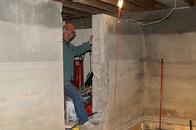

The room is an old cistern. I am sure the Berlin Wall came down with less effort and dust than just cutting a doorway into this room. It is nearly 7' x 22' and mostly +8' high. For anybody who can't figure out the dimensions because they aren't in metric, the room is about 7' x 22' x 8ish'.:p

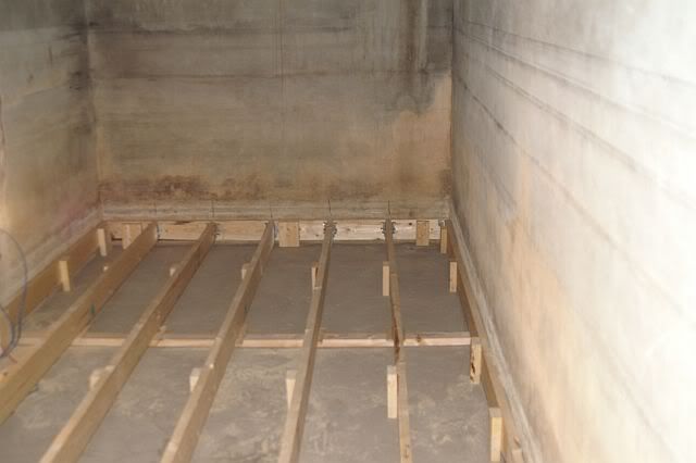

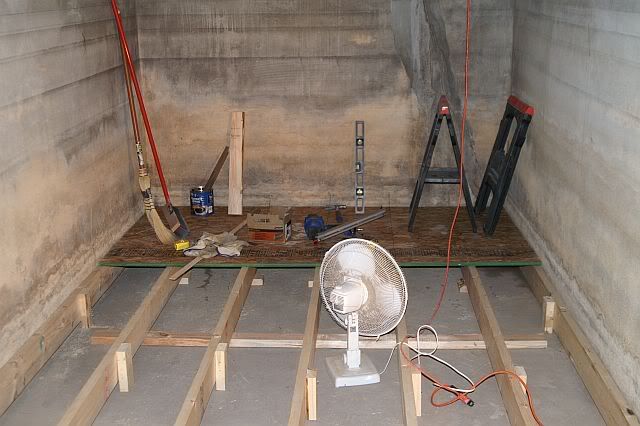

The three outside walls are insulated, the floor is 2x6 joists and 3/4" OSB/Aspenite t&g. Some of the funny little dips and doodles on the ceiling are to conceal the plumbing, with access to taps, traps, etc. The entry door will be reinforced so that an ordinary bashing won't get you in.

Kjohn, you pointed out your room was a former cistern.
There are probably a lot of people on these threads that do not know what a cistern is!
I remembered him posting pics of it just after he cut the door in it. Here is kjohn's thread, and pics, for people that don't know what a cistern is...:p
http://www.canadiangunnutz.com/forum/showthread.php?t=338396
The room looks better now! :D
Good point, H4831. Blargon took care of that one. There may be a few who missed the Bonanza connection though.....:p

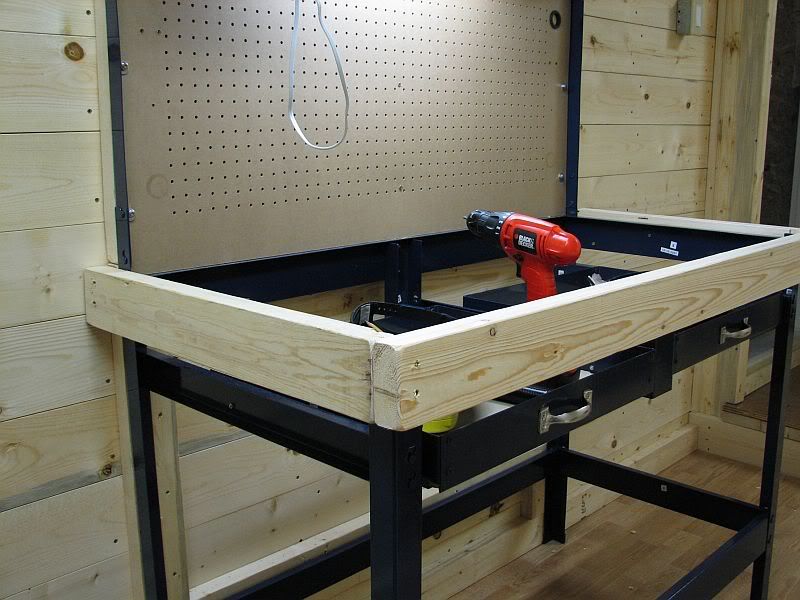

Well boys and girls, I decided to not get too carried away and try to build the ultimate reloading bench, so I am using a Canada Tire bench that I bought on a good sale last year.
First, I screwed 2x4' on the flat to the wall, out lining the frame and cross-members of the bench. Then I butted the bench up to it and started fastening it to the 2x4's, beginning with where the pegboard bolts were supposed to go. Then I made a 2x4 frame around the three sides. These 2x4's are screwed to the frame from the inside.
I left the outer frame 5/8" high, so the top can be flush. I will screw the rets of the back frame to the wall tomorrow when I build up some more steam. I plan to go ahead then with the slide-in tool mount idea. I will screw some ¾ plyboard to the outer frame and to the cheapo table top for a base. I will also have a couple of 2x4's on the flat running the width of the top under the cheapo top. Both layers will be screwed to that. There will also be a leg midway along the front, screwed to everything and mated to the floor. I plan to use some nice oak or ?? for the top layers and for the tool mounts.
So far, I have used three semi-loads of 2x4's, 6 million screws, and a fair few magic words getting those stupid drawers to work. I may build some better drawers later on.
KJOHN,
You have a beautifull project going here. I built the exact reloading bench described in your first post, and I do not regret it at all. The simplicity of changing reloading tool, be it trimmers, presses, etc., is rewarding and worth the initial effort. Solid as the Rock of Gibraltar you can exert the pressure required for the task without any movement or sway.
Whatever you decide good have a good build.
RIFLEF
