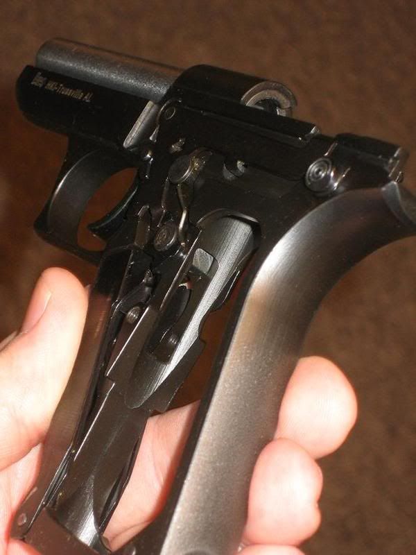

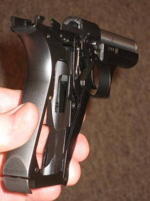

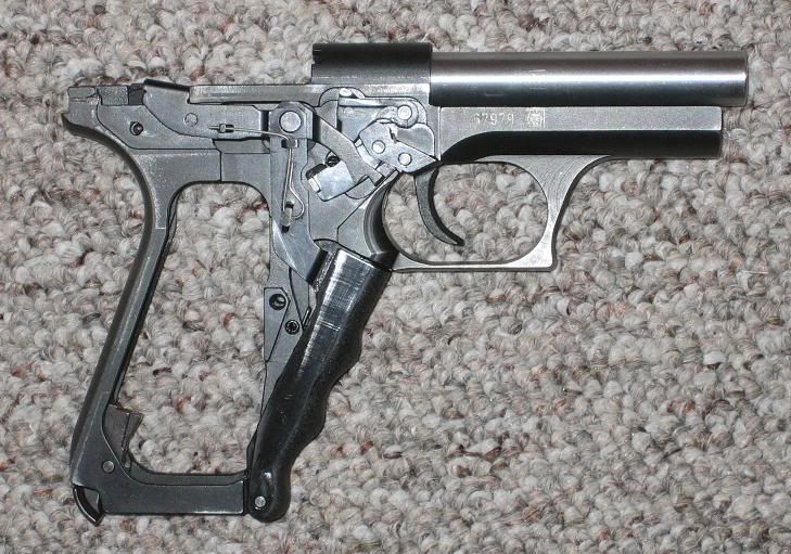

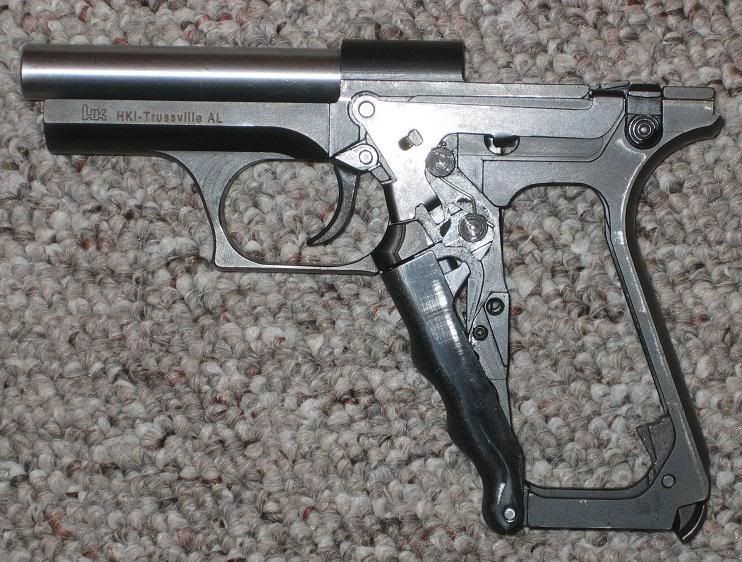

I took the grips off to clean out the whole mechanics of the gun and re-lube it. I would recommend this for anyone that buys one, as it actually seemed pretty gritty in there. I did shoot like 150 rounds before doing this though. The slide-stop mechanism is on the left side, trigger mechanism on the right side. You can see how that weird little "button" works - which you can use to engage the slide stop when the mag isn't in the gun.
The grips come off by unscewing the screws and then sliding them forward. The book says not to try and pry them up, and I'm sure that is good advice.

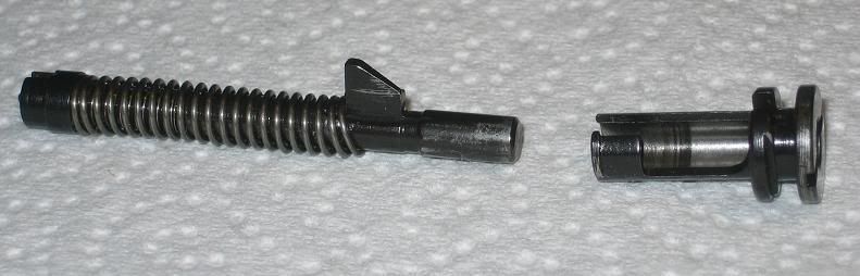

The firing pin and it's carrier will come out if you take the little tool that comes with the gun, press it into the back of the slide and turn it a one-quarter turn to the right (clockwise). The firing pin carrier are one unit when they come out, but it doesn't take much imagination to see how they fit together. You press it in turn it so that "shark fin" engages the catch. To reassemble the pin and carrier into the gun, just slide it back in and then take the wrench and press it in even further, so that it is a couple mm below the back of the gun, then turn it a one quarter turn to the left so that the notch is vertical.
