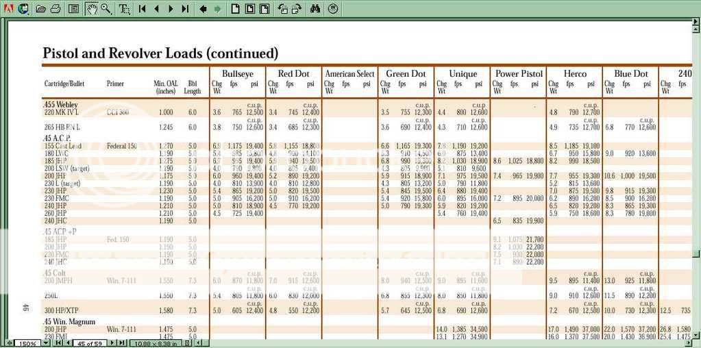

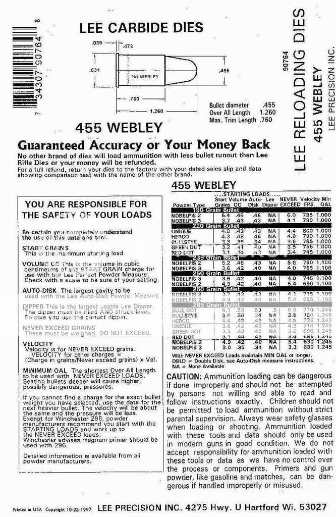

An older manual had data with Nobel powders too. The Alliant data came from that company's free guide:
http://i191.photobucket.com/albums/z76/kg427-2/LEE455Webleydatacroppd.jpg
http://i191.photobucket.com/albums/z76/kg427-2/Alliant96-98_45data.jpg

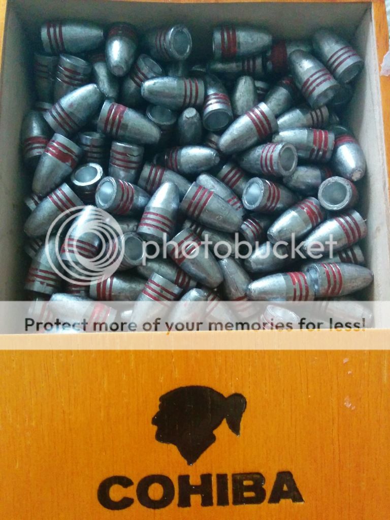

if guys are looking for bullets , jethunter is the first guy I would contact . he makes some very nice soft bullets that won't wear out your barrel .

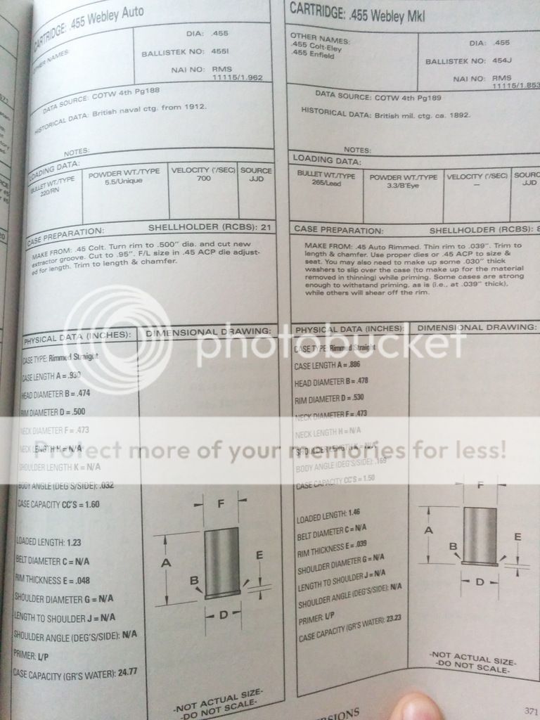

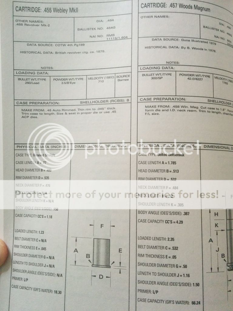

Here is the handloader's manual of cartridge conversions (4th edition) Webley
Webley Auto & Webley MK1:
Webley MK2 & 457 Woods Magnum:
Jet's work:
