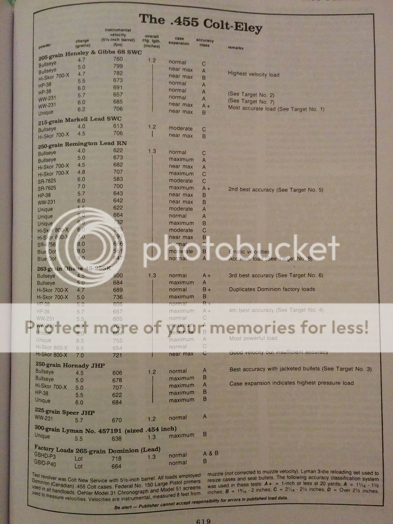

So the wolf round nose lead loads are safe in a MK VI?
- And a Mk. VI is a much stronger pistol than is a Mk I - the metallurgy improved throughout the Webley's production, and each Mark was stronger than the one before it. I definitely would steer to the mild side for a Mk I, and I doubt I'd risk 500 fps from a 4-inch barrel.
You might consider reloading with black powder for a Mk I.
