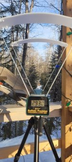

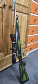

Chatted with Ron a few years back and if he's interested in the project it can move fast, dropped a Stainless 700 Rem in 30-06 off to him December 05 and it was ready in early February. It was a re-bore and I believe a 1/14 gain twist 24 inch barrel. It was under $400 cash. Anyways got it home and worked up some handloads, recoil was ferocious LOL and several anomalies came out. First the speeds were about 100 fps higher at less than max loads (no pressure signs at all) second, it was neat how the 225 grain Sierra, Accubond, and Partition all shot into a one inch group! One their own, each one of those loads (4046, Varget, CFE 223) grouped under an inch. I had the bore looked at by a local smith and he was impressed. Would I do it again? Absolutely, added a muzzle brake, Trigger Tech Trigger, Stockys stock and some bedding. Speed in the chronograph was CFE223 and 225 grain Accubond. I have dropped the speed to 2830 fps for recoil reduction and lets face it, that's plenty.
