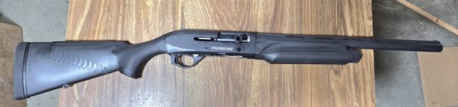

That looks good, might have to look for a Comfortech, the VR-66 stock isn’t awful but that is definitely an improvement 👍
Has a longer LOP that I was looking for. With the original stock I had to use a slip on recoil pad to make it comfortable. Great little guns.
