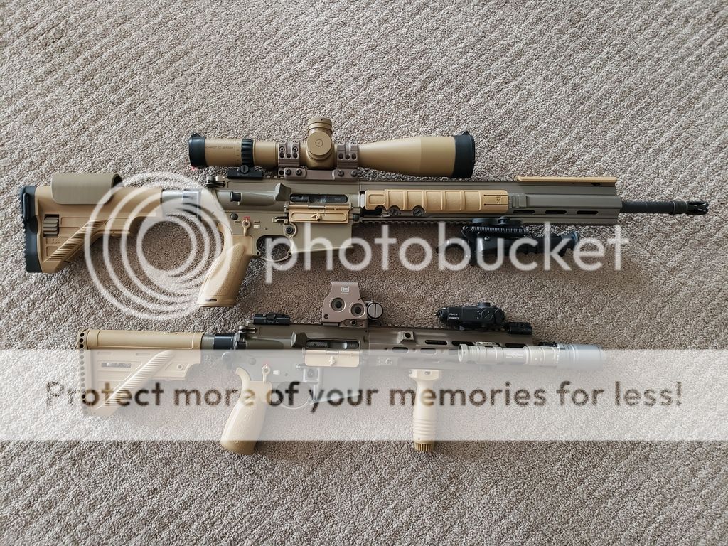

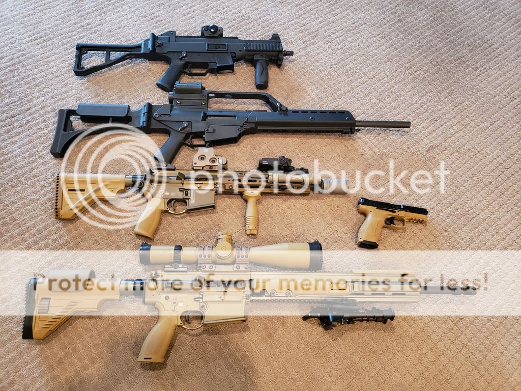

I was asked about the dbal on my mr223 so here's a picture of it with it on. Finally got my mr308 it's own vertical grip too
And for the hell of it more hk goodness
