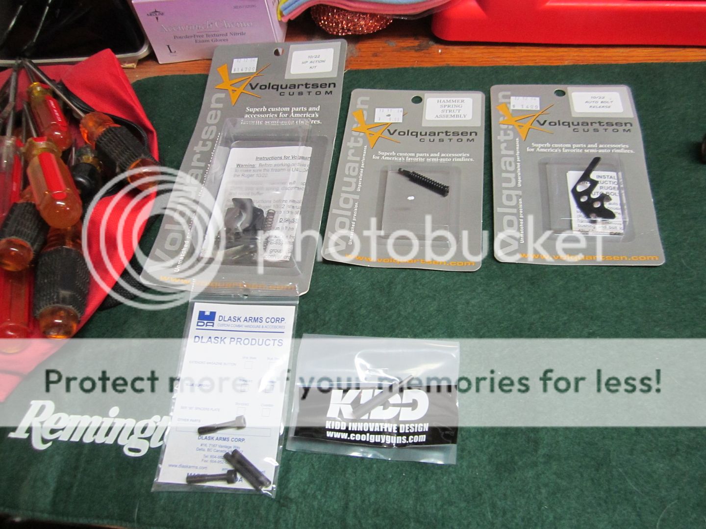

this is all the stuff i put inside it for him

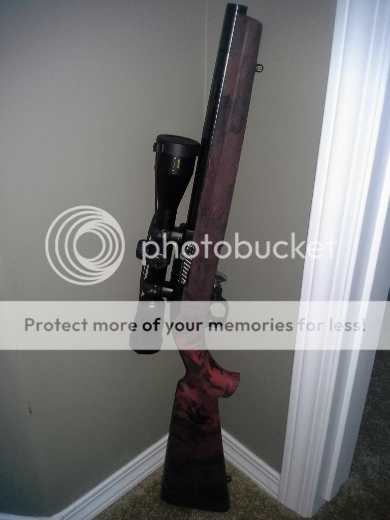

my shortty 10/22 - Dlask 8.5" with a Timney trigger and Kidd inards on a Boyd.
