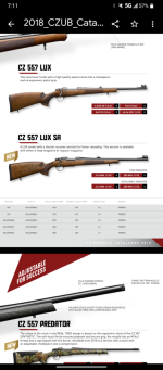

The 557 Lux came in a standard floorplate model (long action) and I have one of those too (8x57), but also in a short action with a 5-round detachable magazine (308 and 243 only). The 243 SA Lux is very rare as it was only made for 3 years (2018-2020). Apparently, the short action Lux also came with the standard floorplate too, but I haven't seen one.

I had a 557 eclipse in .308. Irons were great, rifle was far too heavy for my application and the aftermarket parts were very difficult to come by, IF anyone made them.
The Eclipse was their entry model and very decent. My short action Lux with 20" barrel is more of a middle weight. I have a PGW pic rail and an NECG peep site, and a spare OEM synthetic stock as the Turkish walnut is way too nice to bang up. I really like mine as it fits me well and its just as accurate as any of my T3's. I have lighter rifles too, but all fill a purpose. As an aside, I have really grown fond of 243.

the 557 is a beautiful gun. when you say 10 round magazine are you referring to the 557 Ranger model? I thought the standard Lux had a floorplate magazine?
The rifles are identical except the stock style/ wood (beech vs walnut) and the Range model has a factory installed pic rail. The 10-round Ranger mag fits the short action Lux.
