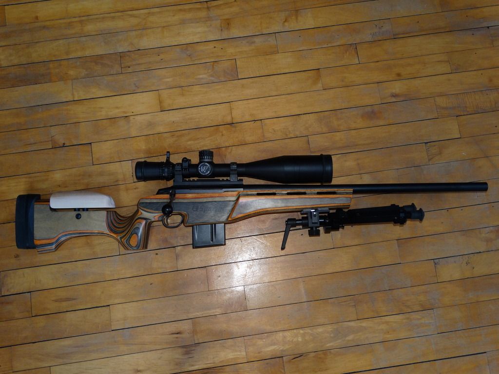

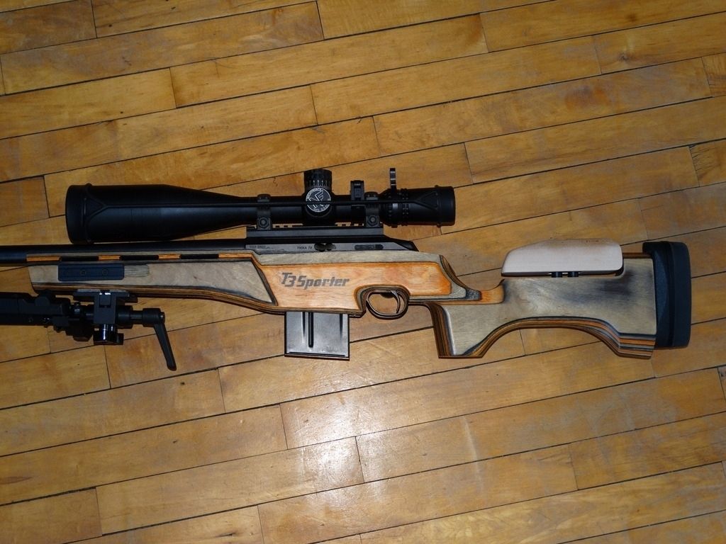

Hey everyone I'm looking for some advice from people that have been following or shooting in PRS type matches. I have a Tikka T3 Sporter in 260rem that I would like to make a little better suited for PRS type matches.
The first big problem is the stock being pretty well right hand only. I've already made a new cheek rest that is symmetrical on both sides. (the factory one favors a right hand shooter.)
Next I have to make room for my trigger finger on the left side. I think I will open up a finger grove on the left side similar to how they did it on the right side.
I also want to open up the magwell similar to how the TRG is. Currently I can't easily get to the mag release.
My last question for now is where to add sling QD's? I bought a Rifles Only FTW sling and got the QD attachments.
What does everyone think of my plan? Anything else I'm missing? Its not to late to stop me from ripping into my sporter stock.
Thanks!
Heres some pics of how it sits now.
