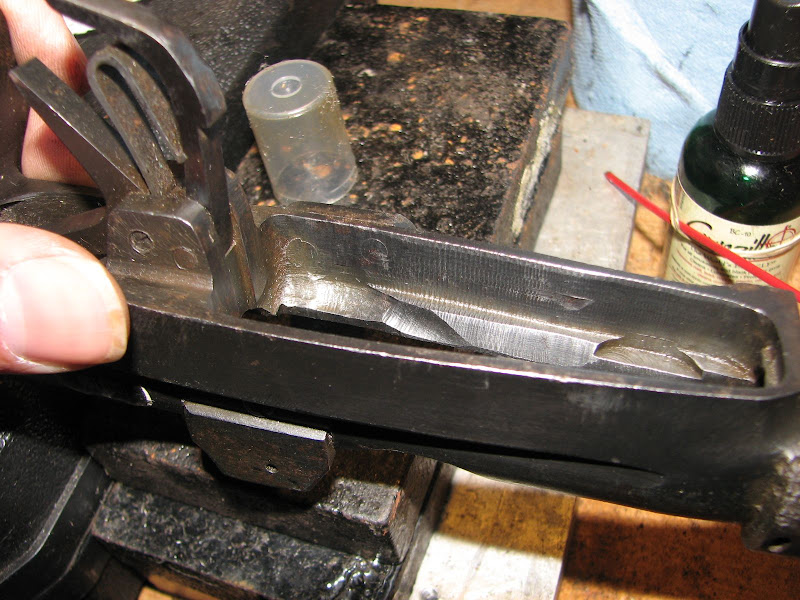

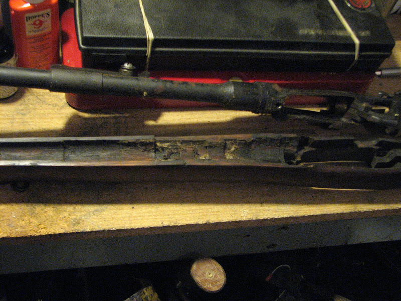

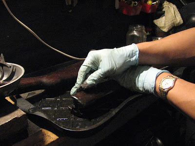

Still the results are worth it! Check out the progression:

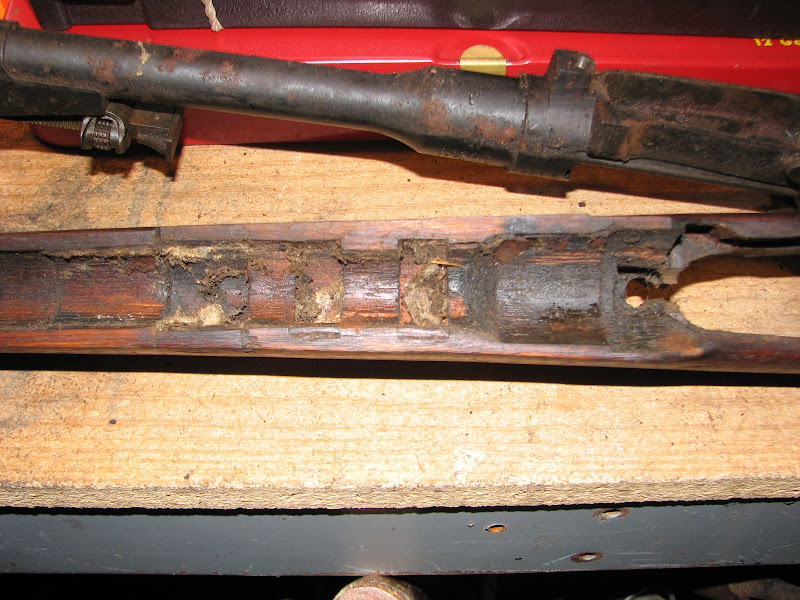

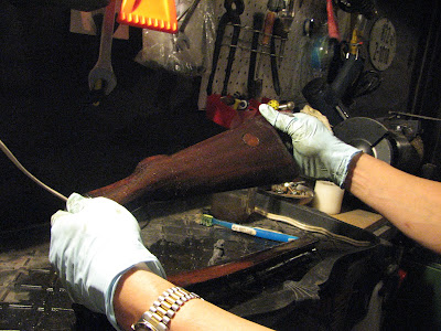

1. I used an old boot tray that I'm certain my wife would not miss. Soaked the steel wool in solvent, and scrubbed like hell.

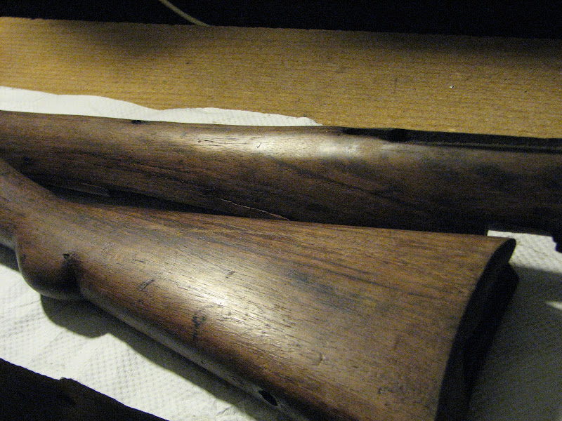

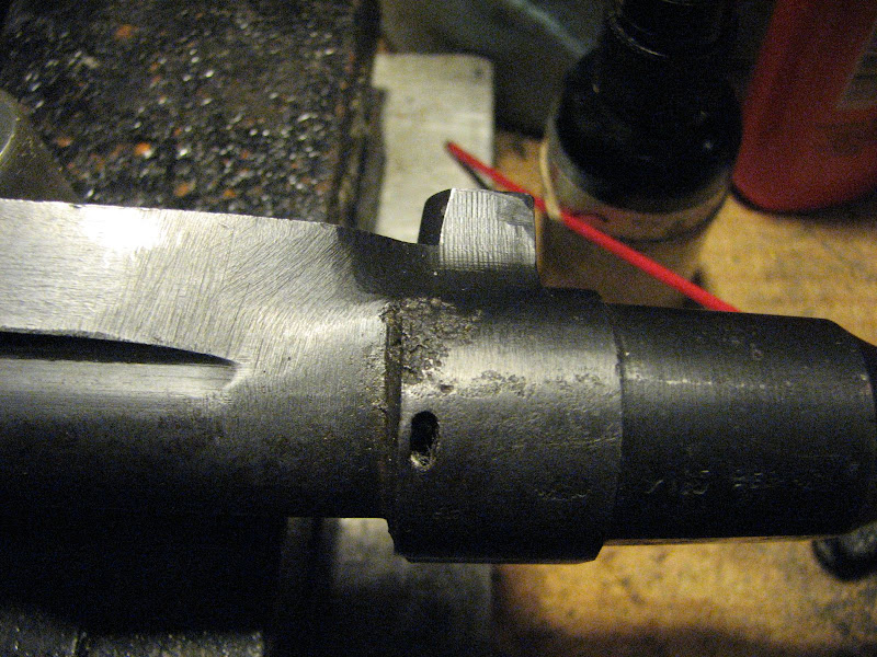

2. More and more scrubbing and some clear wood is beginning to show!

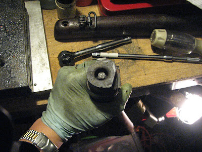

3. Same goes with the buttstock (hate that little wood plug!)

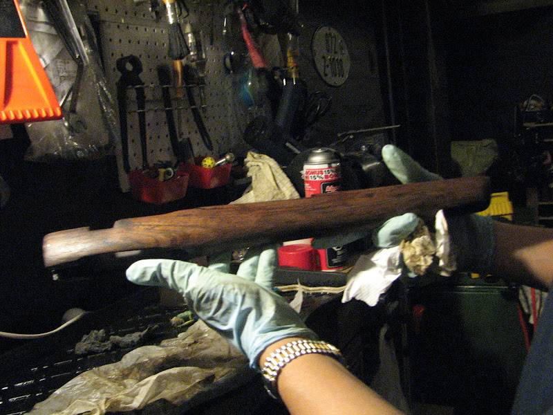

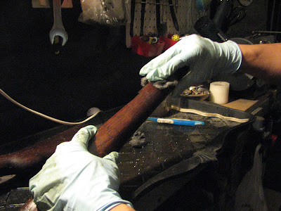

4. I can assure you, it was hard work!!

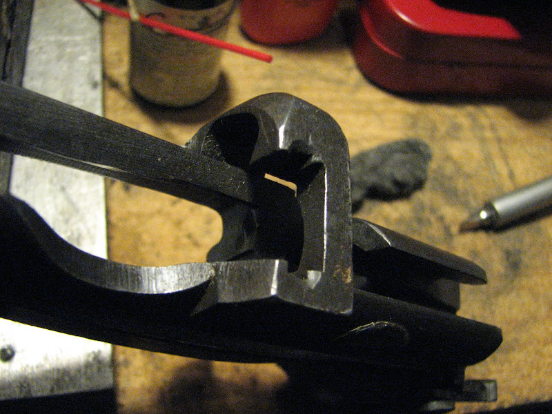

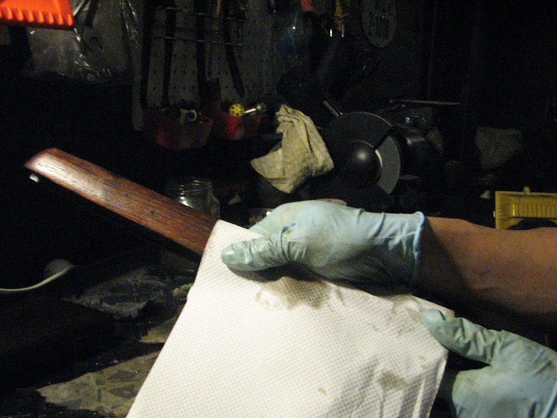

5. But the results are showing!! Look at this...wipe away excess solvent and, spray with Brake Kleen and...

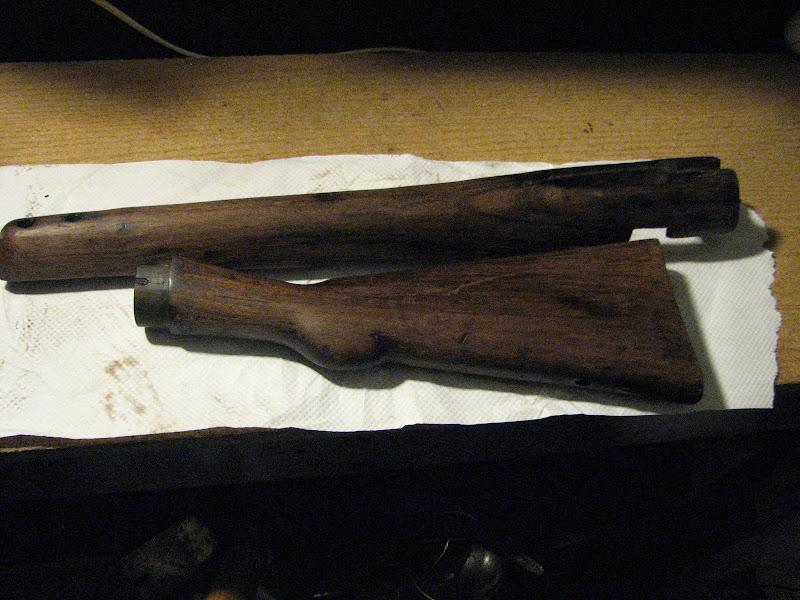

Bear in mind...this wood was almost black before.
6. Now I gotta fix The Damned Crack as Smellie calls it! I thought of using wood glue. Thoughts anyone?
Here are some random shots of the wood.
The better side of the buttstock...

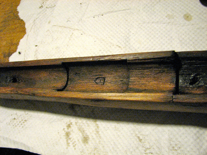

And finally, the inside of the forestock has an "H" inside a "house" symbol. Any idea what this means?
That's it for tonight folks! FYI, it was my daughter who likes guns that took the photos whilst my hands were dripping with solvent and all the other chemicals. Poor dear got a headache soon after.
