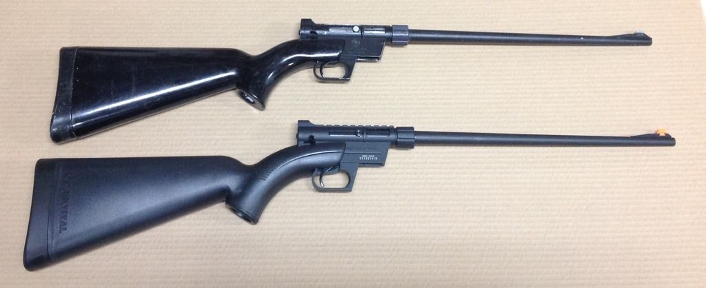

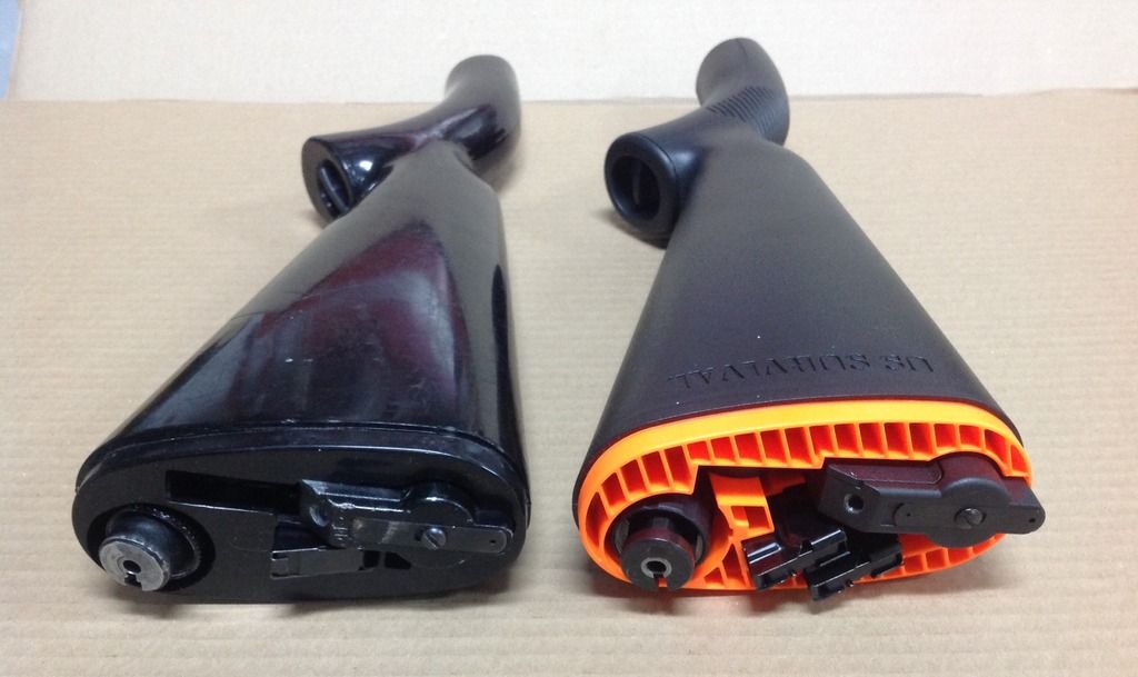

I did a quick comparison between my Charter Arms AR-7 and the Henry version.
The butt stocks are different.
Charters Arm AR-7
- the butt stock is full of foam and is smooth.
- there is a storage compartment for one magazine, the receiver will not fit in the storage compartment with a magazine inserted in the mag well.
Henry U.S. Survival AR-7
- the butt stock is hollow as far as I can tell and has some grooves on the pistol grip to provide some grip.
- there is storage for two magazines, the receiver will fit in the storage compartment with a magazine inserted in the mag well permitting a total of three magazines to be carried.

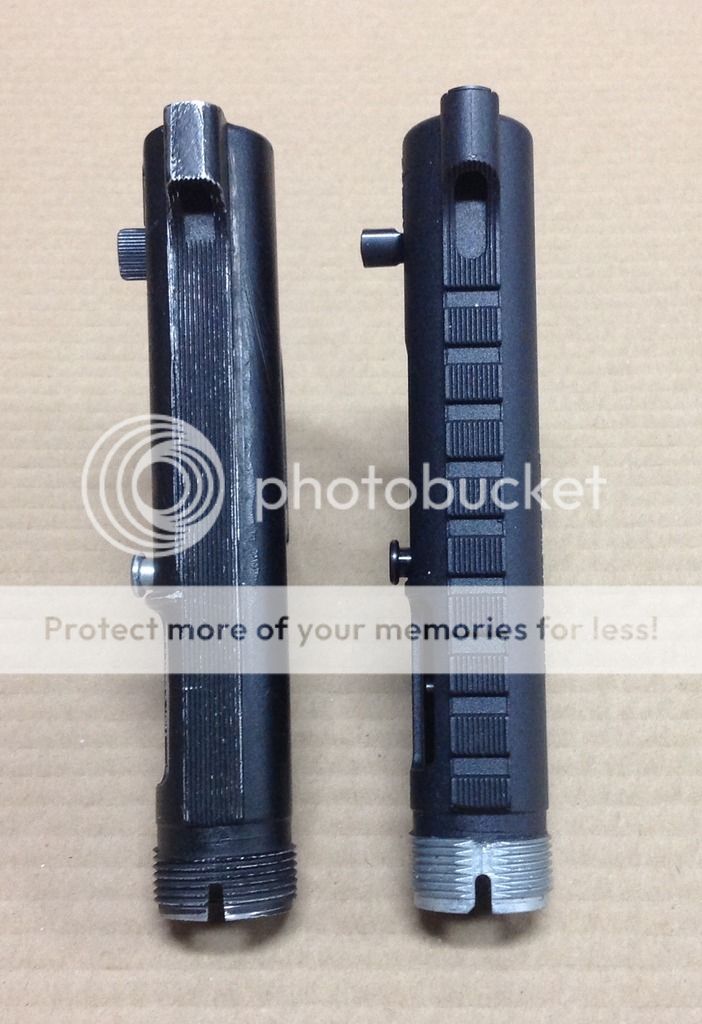

Receivers

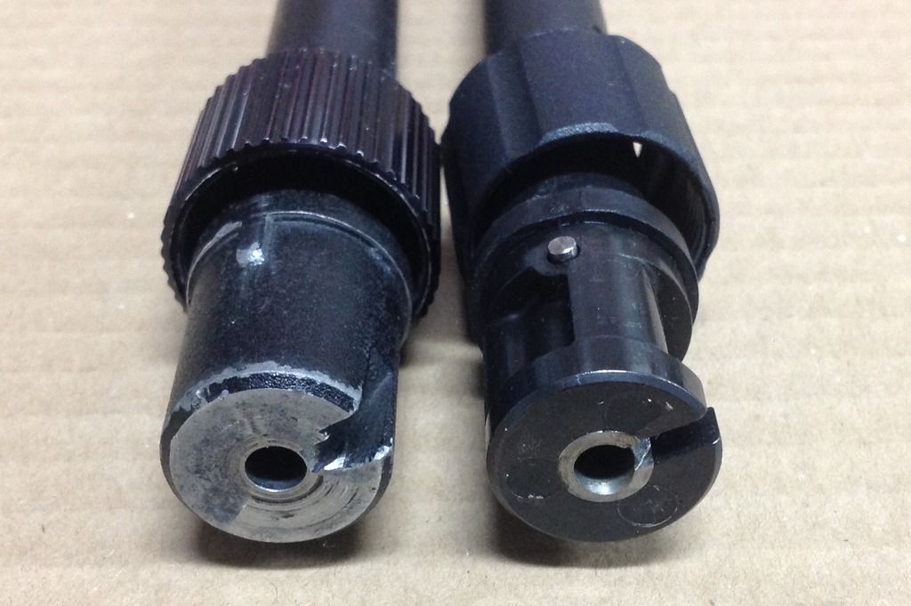

The Charter Arms rifle has no provision for attaching optics. The threads around the receiver are even all the way around and the barrel threads on easily, this may be partially due to how many times it was been installed and removed. The safety has some ridges on it to provide some grip.
The Henry rifle has a rail which will accept rimfire scope rings. The threads on the receiver have flat spots at the 12 and 6 o'clock positions. The barrel does not thread on smoothly. The safety is smooth.

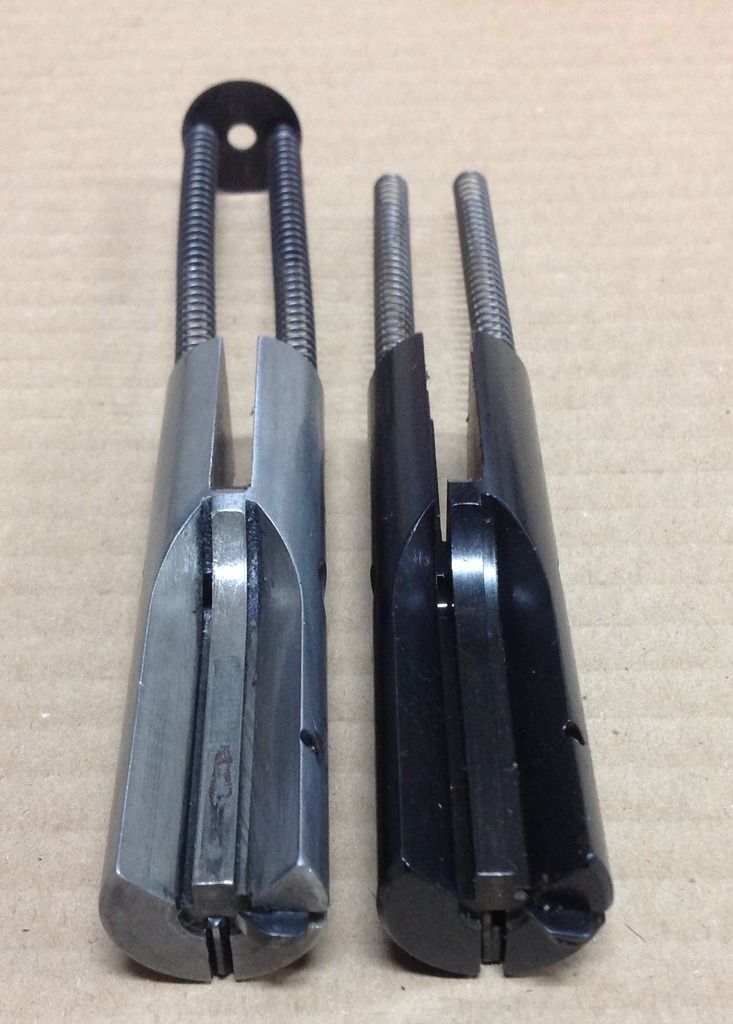

The Charter Arms rifle bolt cannot be removed without tools. The receiver slide plate has to be removed with a flat tip screwdriver. The magazine latch, magazine latch spring and ejector have to be removed and then the bolt can be removed with the action springs and spring guide. If care is not taken the trigger assembly can pop out of the receiver.
The Henry rifle bolt has a cut out which permits the bolt to slide past the ejector so the bolt can be removed without tools. The springs can be removed but the action spring guide cannot be removed.
Barrels
The Charter Arms barrel is aluminum with a steel liner and it does not have a feed ramp. The magazines act as the feed ramp.
The Henry rifle is a steel barrel surrounded with a plastic sleeve. The magazine still has the fed ramp but the barrel also has a small fed ramp.

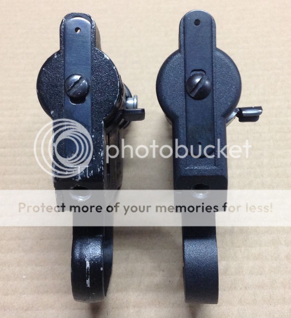

Sights
The Charter Arms rifle has a single peep sight.
The Henry rifle has a large and small peep sight. Remove the screw and turn the rear sight 180 degrees to change the sight.

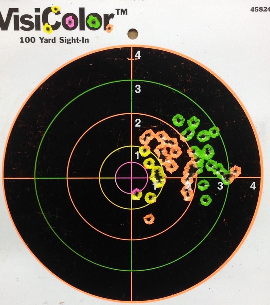

First Range Trip - the goal was to fire 100 rounds to break in the rifle. Shooting was done in an indoor range at 25m using a table as a rest while seated in a desk chair. Only my elbows were supported on the table. Ammunition was Federal Target 40 grain Lead Round Nose. 96 rounds were actually fired and 12 stoppages occurred. 11 stoppages occurred with the same magazine. When the first stoppage occurred I noticed I was holding the magazine and pulling the magazine to the left with my support hand. It does not look damaged but it seems odd 11 of 12 stoppages occurred with the same magazine. Only the last stoppage (Round 90) occurred with the other magazine. The blaze orange front sight is a big improvement over the black front sight on the Charter Arms rifle.
Round 14 - failure to feed, the cartridge was fed at too steep of an angle and the bullet struck the top of the chamber damaging the bullet.
Round 28 - failure to feed, same as 14.
Round 30 - failure to eject, the cartridge case stove piped.
Round 31 - failure to eject, the cartridge case remained completely inside the reciever.
Round 42 - failure to feed, same as 14.
Round 45 - failure to eject, stove pipe.
Round 49 - failure to eject, same as 31.
Round 59 - failure to eject, same as 31.
Round 64 - failure to feed, same as 14.
Round 65 - failure to eject, same as 31.
Round 66 - failure to eject, same as 31.
Round 90 - failure to feed, the cartridge remained in the magazine and the bolt travelled over the cartridge. Re-cocking the rifle caused the round to be chambered properly and fired.
The target shows the first 47 rounds. The rifle is shooting to the right. The front sight is off centre but I didn't have any tools with me so I did not try to adjust the sight.

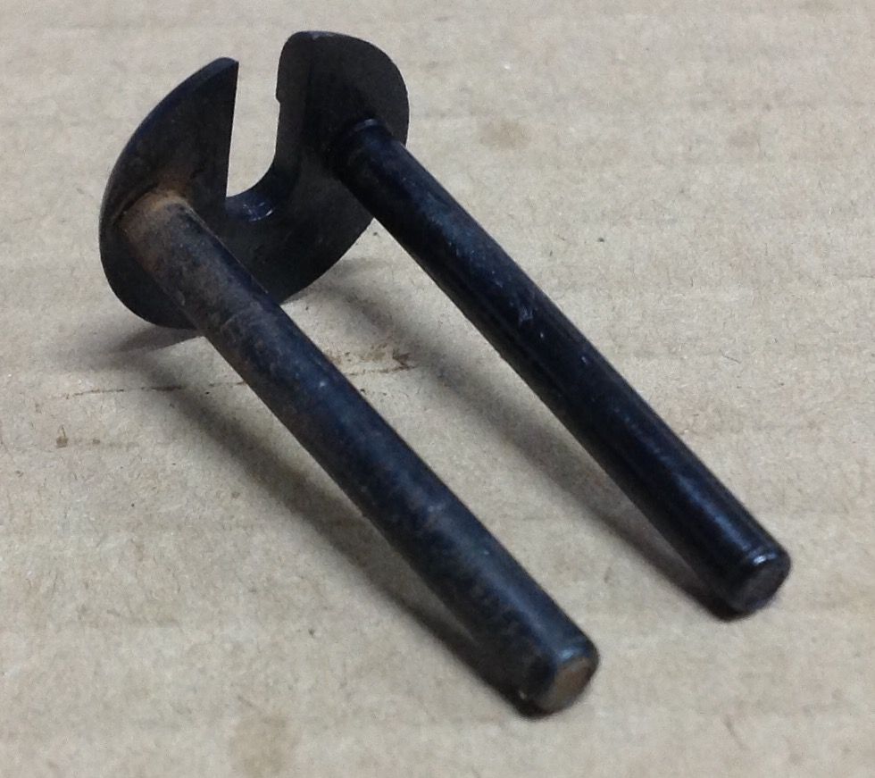

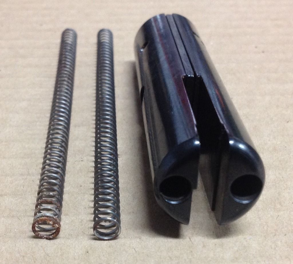

When I got home I stripped the rifle for cleaning. Quite a bit of crud in the reciever. I had not previously removed the Action Springs from the bolt. One was stuck in the bolt due to corrosion. The corrosion on the spring is visible in the photo. There was also some corrosion in the spring hole in the bolt but it is not visible in the photo.
Corrosion residue is also visible on the plastic Action Spring Guide. I was incorrect in my earlier post when I stated the Action Spring Guide could not be removed. It also has a cut out that permits it to be slide past the ejector.
i had some of that corrosion on my bolt as well but it was on the ejector spring and the firing pin spring, i had to remove the roll pins to get them out.
only reason i pulled them out was i saw some orange rust liquid coming out when i cleaned it last so i was concerned.
looks like the springs rust on these guns, easily and bad!
wonder if anyone makes a non corroding spring for these?
kinda makes me feel good mine isnt the only one with rust issues on the new gun.

I can't see any rust anywhere else but it's hard to be sure. After the next range trip I'll open it up to confirm. I wonder how many people have these tucked away in trucks or bush planes and the springs are getting worse. So far I have not been able to find any replacement springs that are identified as being of better quality.
