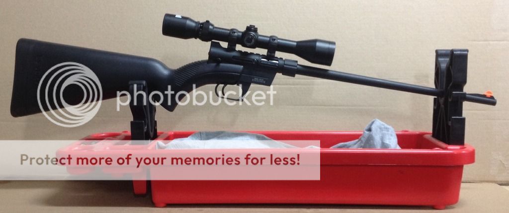

Purchased a set of Weaver 1" High .22 Cal Scope Rings for 3/8" Grooved Reciever so I could mount a Bushnell 3-9x scope I had sitting in the spare parts bin.
First disappointment, the hole on one of the rings for the clamp screw wasn't threaded. Not wanting to drive back to exchange it I threaded it myself. The scope had to be mounted around rear sight due to its height. A fixed power scope would provided a little more flexibility for mounting.

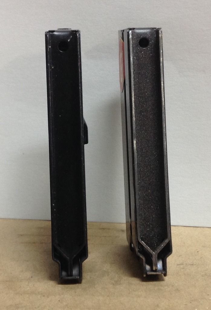

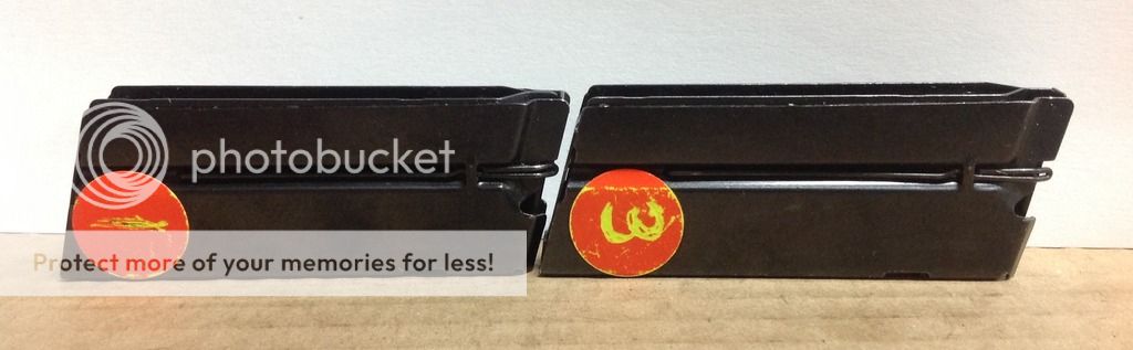

I bought a spare magazine from a site sponsor. When it arrived in the mailbox I grabbed everything and headed to the range. Started shooting and went to use the new magazine and it wouldn't fit in the mag well. Pretty frustrated.
The metal on the top edge of the magazine on the one with the 3 on it protrudes too far from the magazine body preventing it from being inserted into the mag well.
Used my Dremel to grind it down a bit. The magazine on the right is the one that was modified. The bare metal is where it was ground down.
