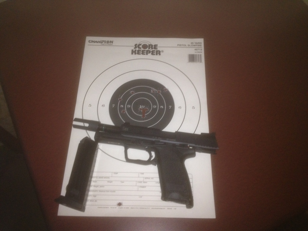

I own an HK45c LEM, actually in the colour you are looking for. I think it is a great pistol and love the colour though mine is the compact model. Bought from Wanstalls. I have never fired an HK da/sa so cant comparebut the LEM system works, just takes a little practice like anything new.
