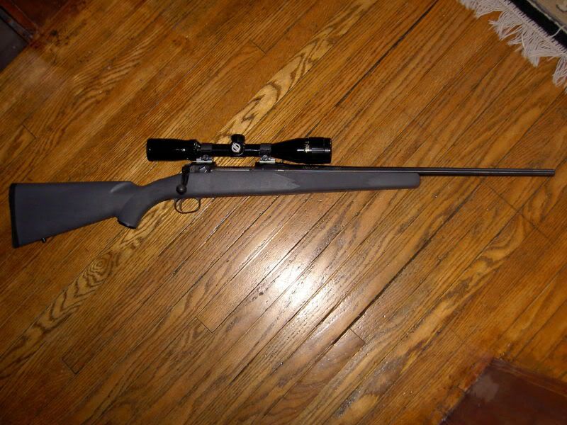

Rifle is my steven's .308, bone stock except for a slight trigger tweak.

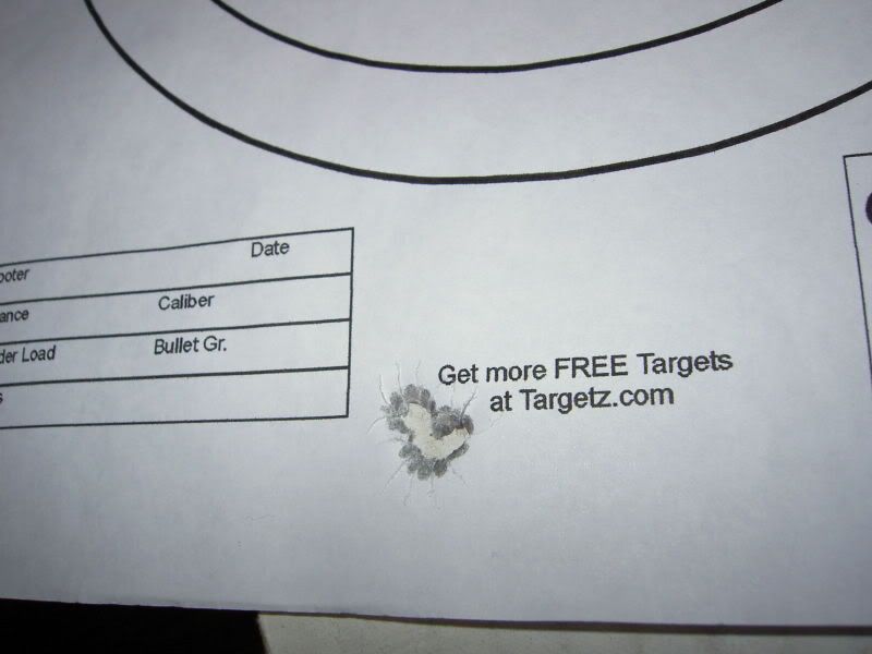

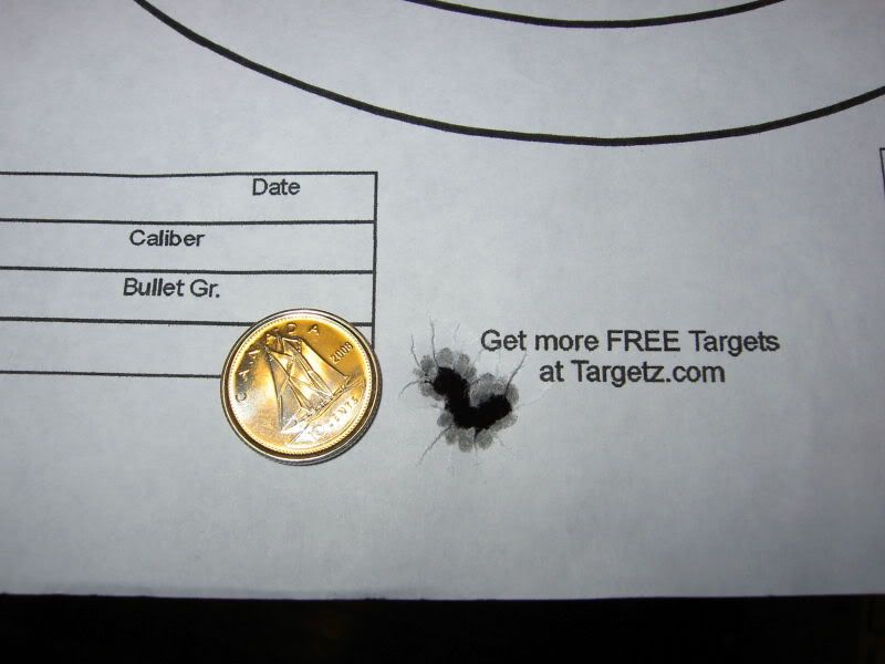

I made up 10 round's today and here are the first 3 shot's from a cold bore.
I shot this with a front rest, -1 today, old 180 winchester bullet's (was given to me and the price tag on the box was $12.95 per 100) 2.5cc powder measure loaded with varget.
This is the best group i have ever fired in my life, but to do it on the first 3 rounds of the first ammo i have ever reloaded was awesome!

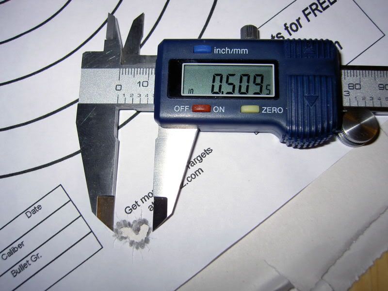

If i am measuring right my .5095 (i tried to measure from powder mark's) minus .308 would be a .2015 group? This was shot at 100 yards at the range i belong to.

What gun were you shooting them out of?
Steven's 200 in .308. I have a 22-250 barrel on the way for it also.
