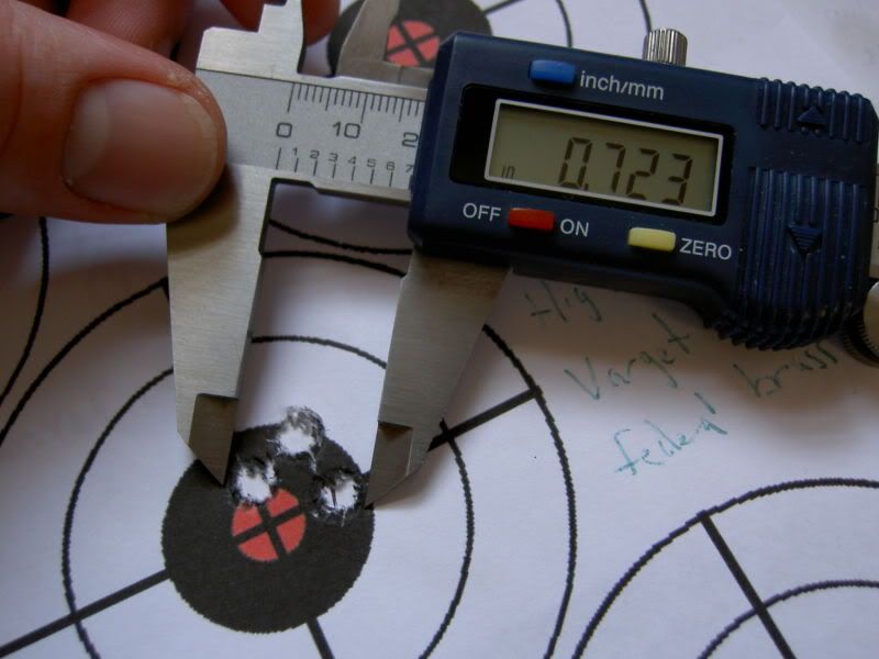

Nice group,did you shoot any more groups?I would separate the brass,since the Winchester and Federal cases normally have different internal volumes,which results in different chamber pressures.

Back from the range with a new report. Today i was trying to see how seating depth played a role in my gun. Let me tell you it make's a huge difference.

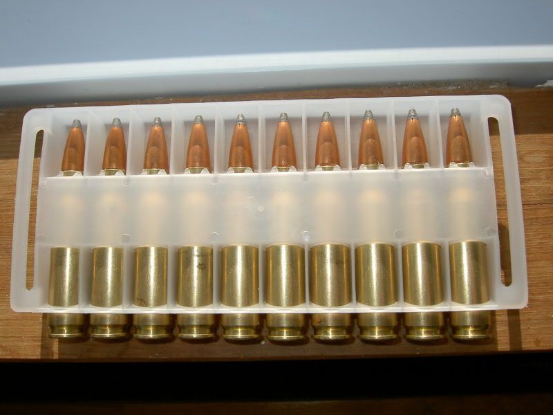

Hopeing to recreate yesterday's grouping i loaded 10 federal brass with the same charge as yesterday (2.5cc). What i did do is seat 5 low and 5 higher. While not a big difference in looks (bad pic) it was a huge difference on paper.

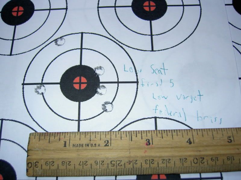

Today is was a bit colder (-4) and there was more wind (15kph). I shot the first 5 with the low seated bullet's.

It would appear that you are well on your way to finding an optimum load for that rifle.
Keep in mind that shooting on cold days often results in bigger groups. I find that cold hands do not help in getting a good release on the trigger. I also find that gloves make it harder to shoot well. :D
