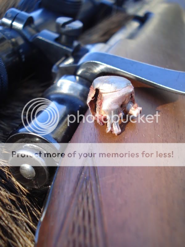

I use the Interlocks most of the time in 25,7mm,30cal,303 currently and have used them in 6mm,270,338 and 375. Results have been mixed from finding just jackets like Harold to finding very nice mushrooms. This is more for reference if it helps you guys as I don't use magnums. Up close any cup/core bullet is going to loose more and depending on what it impacts even at long range it can be suprising the outcome.
This seems like pretty typical performance for the 7mm 154gr
The SST in 7mm is more fragile than the Interlock, Interbond is a fair bit stronger/harder than either.
On the left is a 375 300gr shot from a 38-55 into a pine log lengthwise with the grain, I forget the penetration but it was a solid log and over 24" penetration, that is much easier going than across the grain tho.
On the right is a 375 300gr after going thru the head of a beef steer point blank and three vertabrae, out of a 38-55.
This 30cal 165gr went through the head of a whitetail at over 200 yds, sideways just below the eye. Anyone familiar with the bone structure there knows there's a fair bit but it is light bone. The jacket was found stuck in the hide offside much to my suprise.
