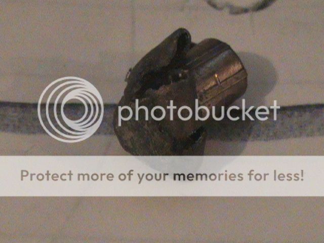

Here is a picture of the only Core Lokt bullet I ever recovered in a whitetail deer.
I weighed it a few minutes ago, and it was 114grains. Given that it started life as a 150gr round nose in 270 Win, weight retention after bouncing off hip bones and lodging in the spine was about 76%. Aside from the peeling of the jacket on the far side from the repeated rendezvous with solid bone, it expanded correctly to about 45 caliber. This was many years ago, so in my neglect to record a description of the deer and circumstances, I can only jog my memory and hope to accurately say that it was a broadside shot(may have been 45 degree); 95% of shots were, and I am sure he was less than 200lbs on the hoof.
