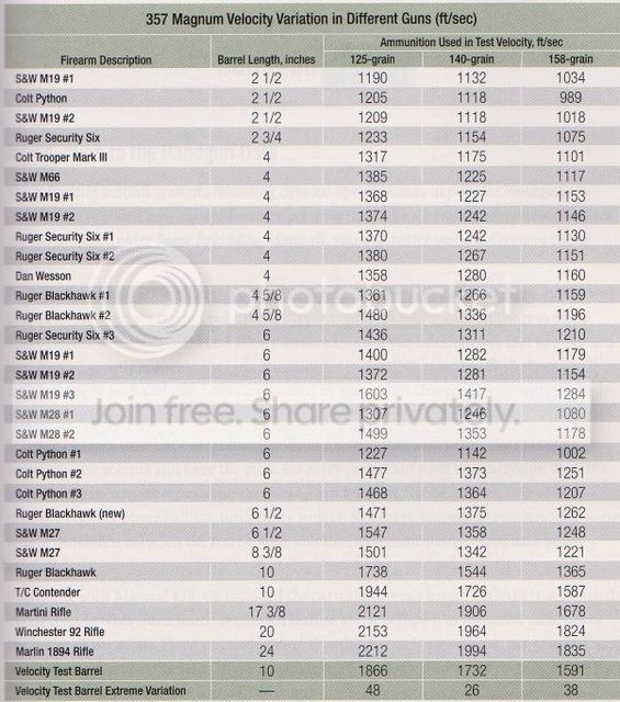

Hey, So I was looking around for some hot 357 magnum loads and stumbled by a load in a speer manual back in the 80s. It showed data for a 158gr jacketed bullet with H110: 15.8 - 17.8 grains. Current Hodgdon load data says 15.0 - 16.7 grains.
Im shooting these hot loads out of a Ruger GP100 4.2" with magnum primers of course. I slowly worked my way up to 17.8gr of H110. I've had no issues regarding flattened primers or sticky extraction out of the cylinder.
I actually have some factory 158gr Federal American Eagle JSP ammunition that I compared the feel to, and they felt very similar. I currently don't have a chronograph, so I couldn't test the velocities.
Have any of you played around with this combo?
