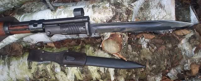

Bayonets work in a myriad of ways, different nations had their own means of locking them on. Oddest one I've seen is the Steyr-Mannlicher 1895 bayonet... There was actually two different ones produces for the rifle. One being the regular knife-type common on most others that doubled as a fighting knife...
But the other one was a strange, twisted piece of metal that used that weird little antenna at the muzzle.
Sorry for the difficult view of it, it's the only one I could find quickly... that's only a training version of course, but the important bit is still there. A fair bit odd compared to the one above.
