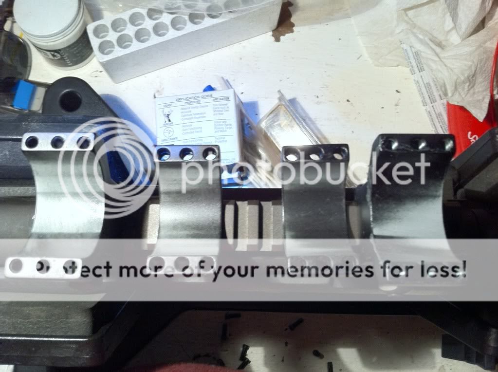

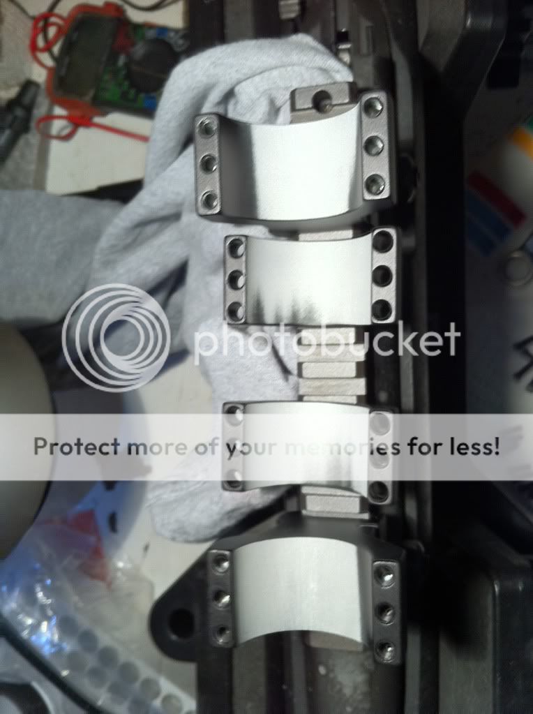

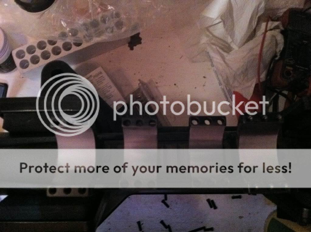

I lapped my rings. It did significantly improve contact between the rings and scope tube, from about 10-15% contact to at least 75% to maybe 85% contact. Then I leveled and torqued the scope down. However I have not made it out to the range to test it yet, but as soon as I do I will report my findings. Thanks to all for the input, it has been much appreciated.
After a Little Lapping
Getting Better
All Done
