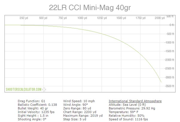

Agree with you. In any practical sense it’s not happening. But if you set up conditions to allow for the vertical drop, then it could come close. Let’s say you fired with no shooting angle off a high cliff overlooking a canyon, or 3500 ft up a mountain — so that the round could continue dropping until the horizontal vector lost all its momentum — then that distance would be over 2000 yards for a 40gr Mini-Mag leaving the muzzle at 1235 FPS.A .22lr of any kind is absolutely incapable of traveling 1.5 miles... Deadly and often underestimated sure but science calls BS on that.

No, you couldn’t be more wrong. I think the lawyer had exactly in mind the furthest distance the bullet could travel under any possible circumstance. That’s how lawyers think, and rightly so. The number they came up with matches almost exactly what the graph I posted says.I doubt the lawyer had people in planes or on mountains in mind when they came up with that number.
