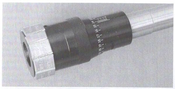

Interestingly, when tuners or muzzle devices first began to see widespread use among BR shooters around two decades ago, using extra weights was very common. Some were more sophisticated than others that were sometimes little more than lead wheel weights. Below, an example of what now may appear strange. The image is from a book first published in 2006.

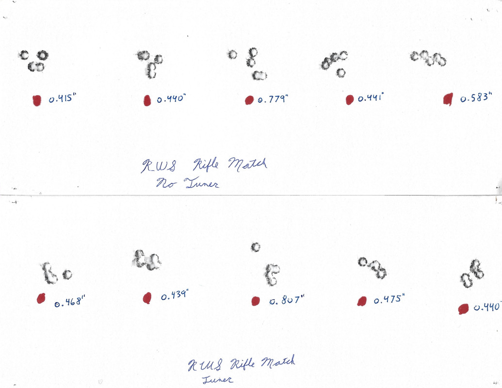

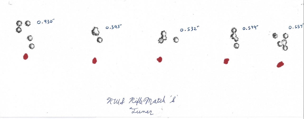

I was able to get out to the range again this weekend to shoot without the tuner and get some data to wrap up this experiment. I've got over 1500 rounds fired, and have seen enough to asses the performance of this barrel. For whatever reason, it is prone to periodically throwing bad fliers, which I will define as ones that make the grouping go over 1/2" at 50 yards. There's no clearly defined interval in which such fliers show up, and the severity is variable with some groups going over 3/4". It doesn't matter what ammo, tuner/no tuner, this is the behaviour of the barrel. Even if I could determine the exact causation of this, I doubt there is anything I could do to remedy it. It may be possible that firing many thousands more rounds could settle down the barrel, however I am not interested in exploring that possibility when there are more fruitful things to pursue. The following targets conclude this experiment.

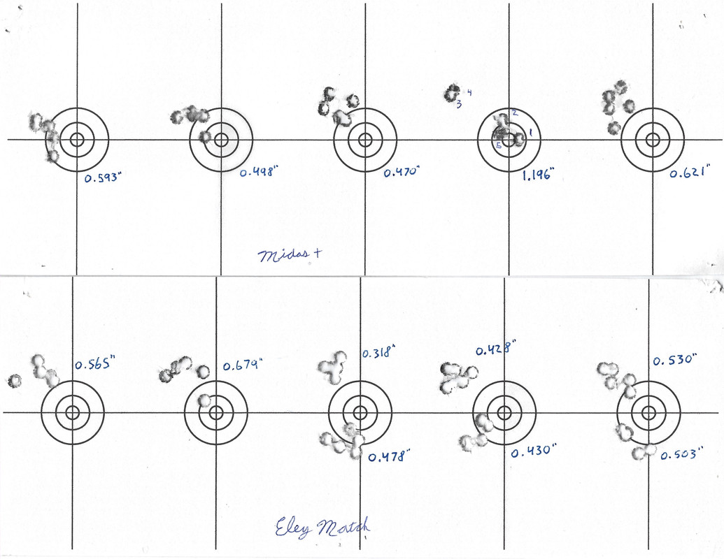

Some ammo like Midas + and Eley Match I'd say performed better when a tuner was used on previous days at the range, other ammo isn't showing much difference either way. I didn't tune for each ammo, one setting was used for all. I am disappointed that this barrel didn't turn out to be a good example of tuner use, though perhaps it'll help people realize that if a barrel isn't giving a good performance, one's time and money is better spent on an upgraded barrel rather than a tuner.
Thanks for following along, this barrel is going to be retired as I move on to building out this CZ into my intended project.
