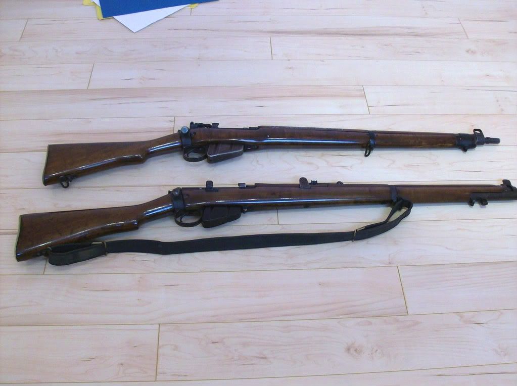

getting there....
So far with a little help from Lou - I have my No1 MKIII* about half way - still looking for good furniture and some metal bits - (see my EE request)
It is a labour of love (and great stress reliever after a bad night in the ER!) - the fun is getting them out to shoot after (cant wait for that!)

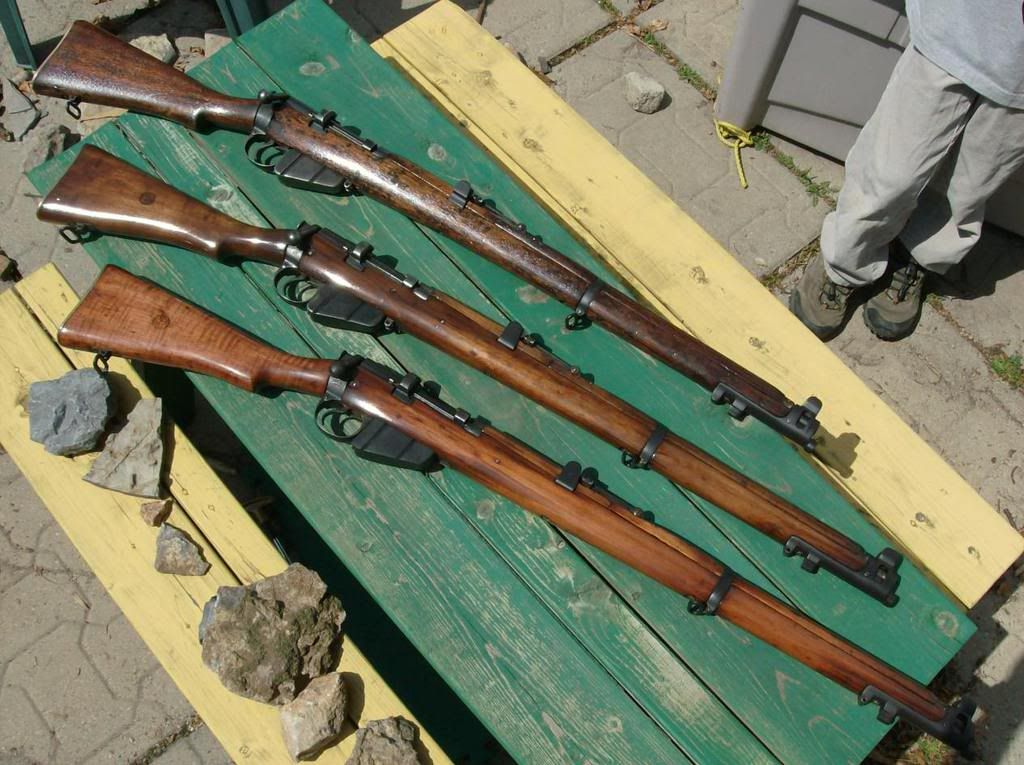

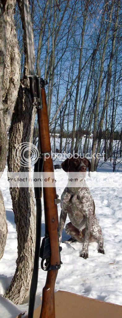

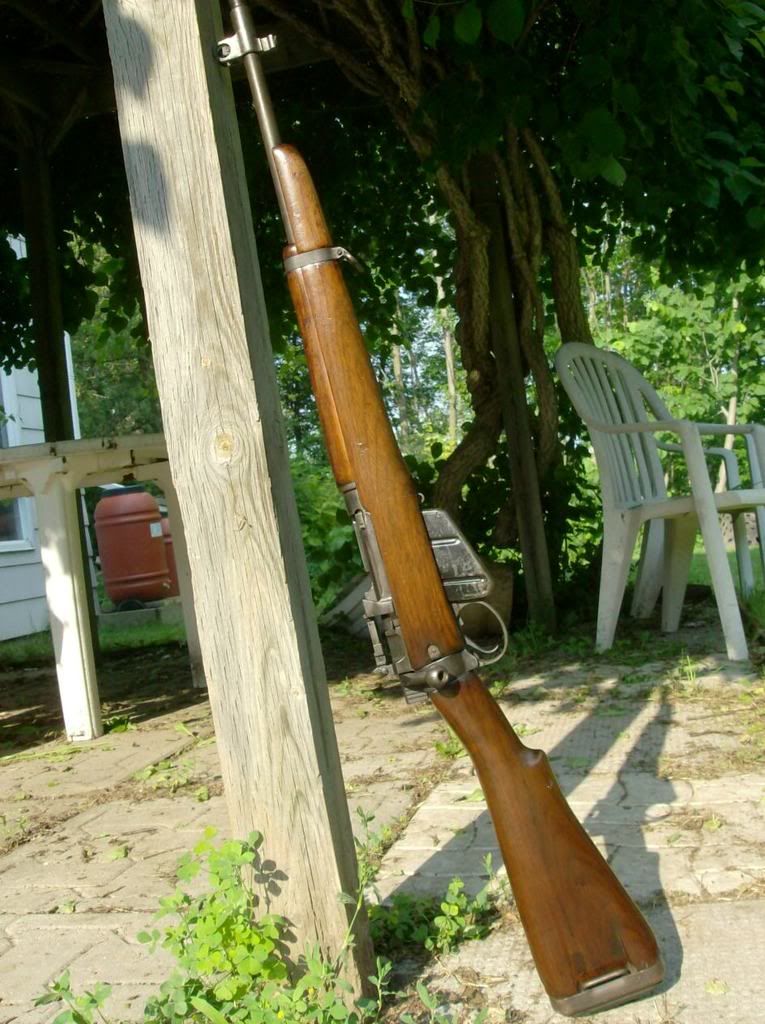

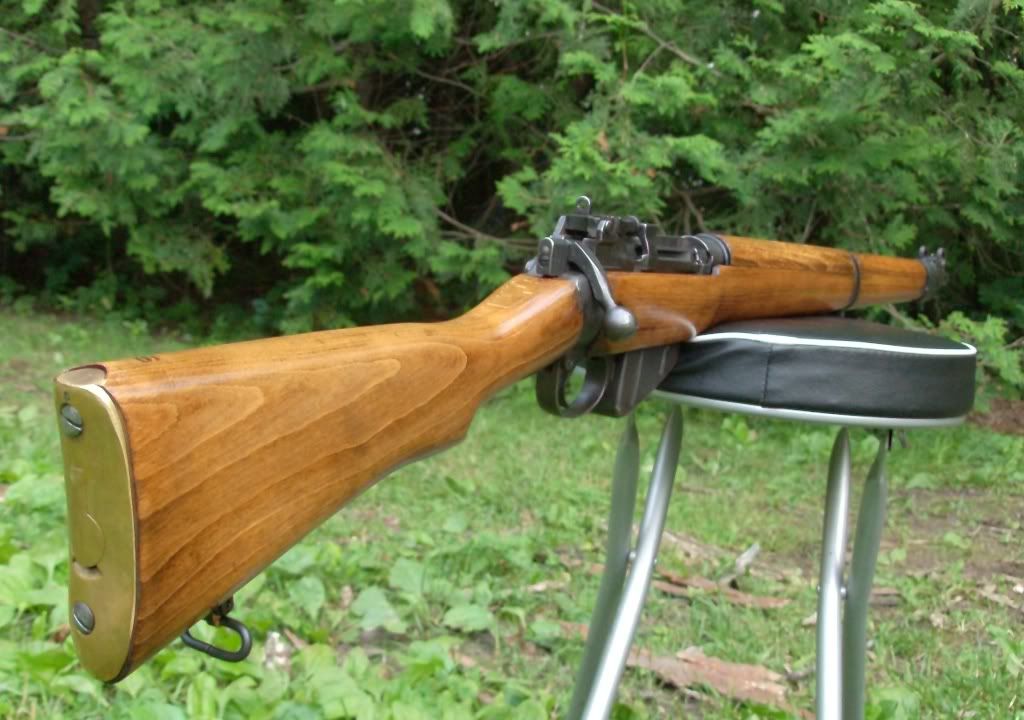

Ok, a few pics.
Why not, here are some of the ones from the past 12 months (all from Bubba'ed rifles, except the Jungle Carbine, it needed welding and refinishing but stocks were complete).
