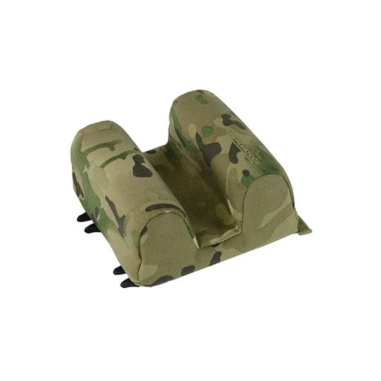

The simple answer would be to put something under the bag you already have... or get something like this to attach to a backpack
