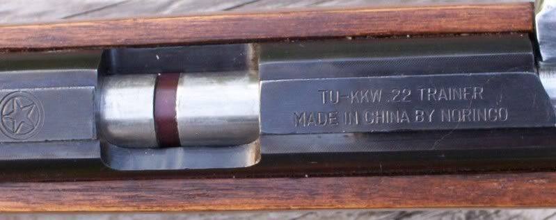

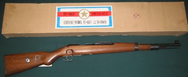

But if you simply google “Norinco KKW” you’ll find out that
these guns were imported by Navy Arms in US.
I’m sure that Navy Arms ordered these guns to be marked TU-KKW.

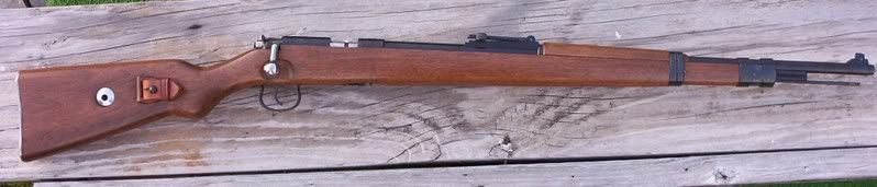

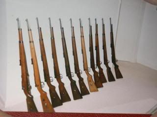

You may also find pics like these:
There was also a short version:
In the last 2 pics, note the distance between
the receiver and the rear sight.
I scaled the last 2 pics and the barrel lenghts seem
to be about 25” iand 20.5” or something like that
which makes the short KKW about the same lenght
as our JW25.

I found references about TU-KKW in US
manufactured in the mid 60’s.
However, I don’t know if they were marked as such
or when they were imported. I don’t believe US directly imported
guns from China before 1971.
Anyway, the quality of all these guns is
way better than our JW25.
Wood is much better looking and without
that crappy paint found on my JW’s.
Also the metal has better finnish.

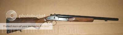

JW2000 is a shotgun.
External hammers, double triggers.
Not my style, but it may be your thing
if you like to play “Cowboys and East Indians”.

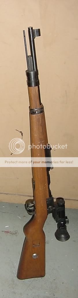

A friend allowed me to take some pics of one of his guns.

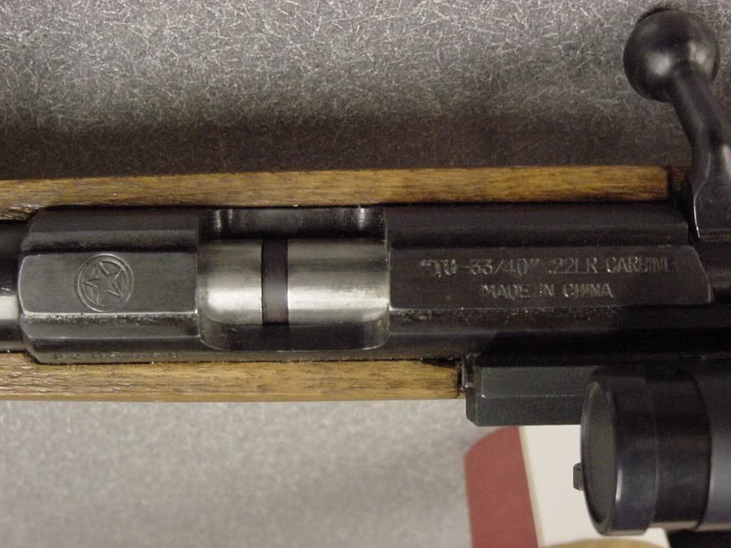

This is TU-33/40.
It’s bought used in US and imported by him about 20 years ago.
He never fired it.

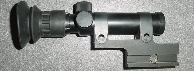

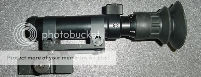

Quick release scope, same lenght as JW25.
MUCH better finnish, much better looking wood.

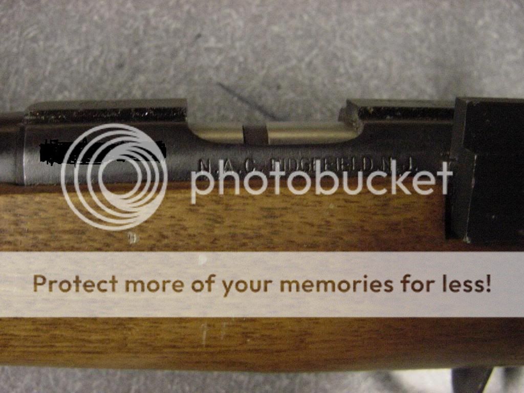

Navy Arms’ import marks read N.A.C. RIDGEFIELD N.J.

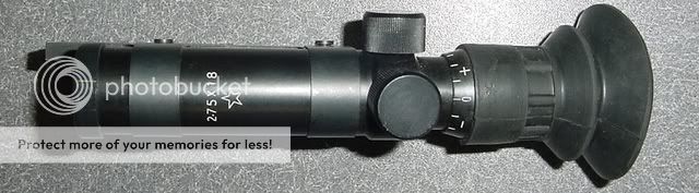

Scope and mount are very neat and excellent finnish.
Scope is 2.75 power with 18mm front lens.
I wish they would import them today.
The reticle is a heavy, thick duplex.
I want one of the scopes for my Norc. Anyone know where to get them.

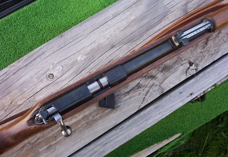

Spent a few hours today and got mine cleaned up. Used a can of brake cleaner that I picked up and that just melted the cosmoline off. After getting into the bolt and hosing it out the firing pin seems to hit harder. I also polished up the bottom of the firing pin and it seems to be running a lot smoother. I used a vise-grip to get the front sight straightened out so it's pretty much centered now. The rear sight is still crooked.
Does anyone know how to remove the rear sight ramp? I'm thinking if I can get it off I'll be able to tell what is pushing it off to the side.

If the rear sight mount is spot welded on -
Use a dremel tool with a small cutting blade to cut the spot welds holding the sight on. Cut on the sight side, not the barrel side.
To get the rear sight out, push down on the hinge pin end of the ramp, then push the whole ramp to the rear of the gun. The leaf spring underneath pushes out to the front. This will allow you to see how the sight is mounted to the barrel

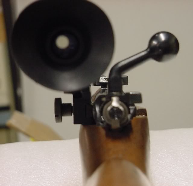

See thru rings

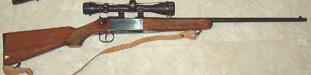

Does anyone have a set of see through rimfire rings that they could slap on the rifle with a small scope and take a picture? I'm trying to decide between trying to get a small scope to fit (4x20mm) or just going to a reddot.
A friend of mine did that to his. See thru rings and an old Weaver 1.5-4 scope with no objective bell. It looks good and the bolt handle clears but just clears the eyepiece.
In my opinion too, the see-thru rings are the only way to go.

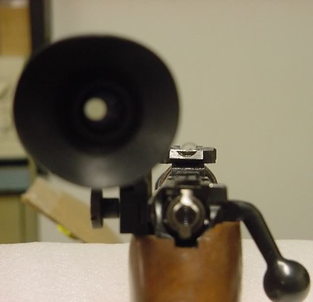

Everything was oiled up again after I did the brake-clean thing.
I found the problem with the rear sight. It looks as though the two hinge posts on either side were cut in crooked.
What is the best way to fix this? Somehow I'm going to have to get both of the posts sitting straight across from eachother.
The safety is stiff because when it is engaged it is having to push the firing pin back about 1/4 inch further than it is already sitting.
I'm thinking with this if I file the two angles on the firing pin that click into the safety back 1/8 of an inch, the safety will only have to push the firing pin back 1/8 of an inch, instead of the 1/4" it is pushing it now.
