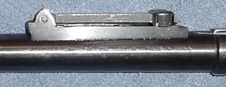

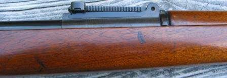

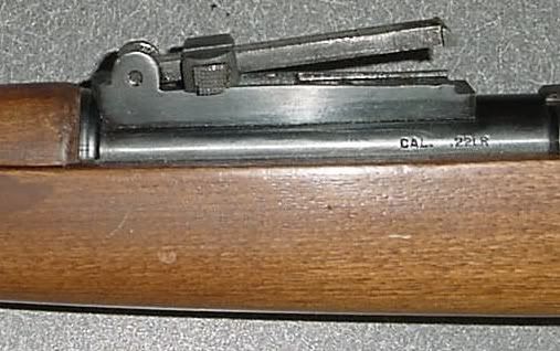

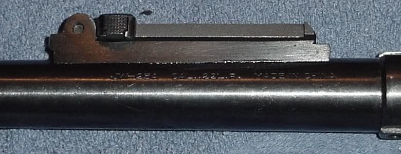

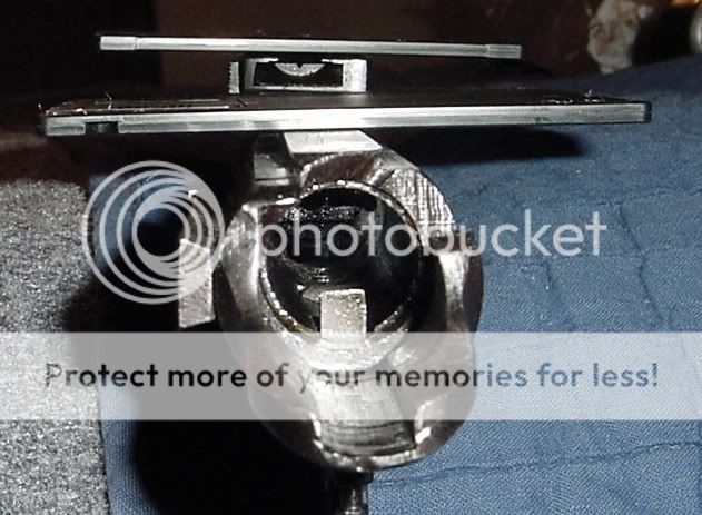

The rear sight of my new gun is a disaster. Maybe you have the same problem.
This is my sight. No sloped ramp, that’s it.
25 meter adjustment.
200 meter adjustment.
It’s supposed to do this, but obviously, it doesn't:

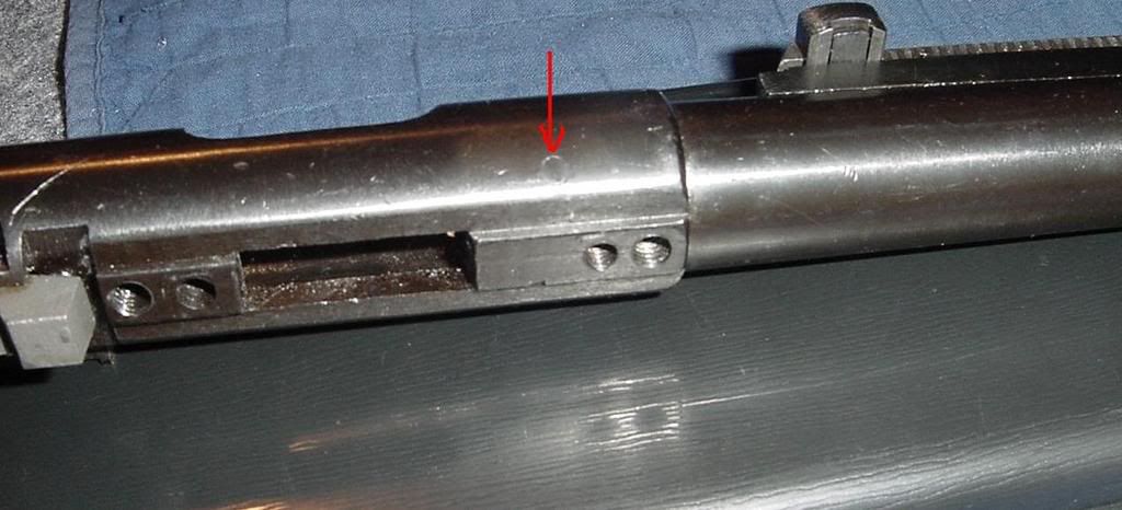

just for info: the rear sight is not soldered on ,its spot welded on.
So far my buddy has altered the bolt and cut off the sights
and mounted 3 x 9 weaver scope with medium height mounts .
You are right.
Yellow arrow shows the tack weld.
The red arrows show the horrible grinding (by hand?) of the ramp.
In addition, mine it’s crooked few degrees to the right.
I didn’t check the front sight, it may be crooked too.
But I was intending to mess with it anyway, so it doesn’t matter too much.
Plus everything has such a crude finish.
However, after cleaning, I quick-printed the action and it’s straight.
It has contact 96% or better, which is more than acceptable for a new gun.
I also checked the bore. It’s straight and it has a nice crisp rifling.

As for your ramp, it looks like they forgot to install one at the factory.

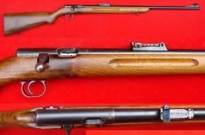

In 1934 Mauser introduces the DSM 34 (Deutshe Sportmodell).
It didn’t have a bayonet lug and allegedly it was only single shot.
Internet bullshyters and wannabe historians will tell you that
it was for the purpose of not attracting the allies attention
upon the new gun intended for training.
Bullshyte! Germany managed to build (under allies nose)
tank factories, submarine huge dry-dock type factories
and so many other things.
I owned few of these DSM 34 trainers build by Erma, Walther, Geco
and in my very young years I improved my shooting
by using enough of them to tell you for sure
that magazine models exist in DSM 34.
It was produced not only by Mauser, but also by Menz,
Erma, Simson/Gustloff, Walther, Geco, Haenel, Bruner, between many others.

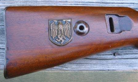

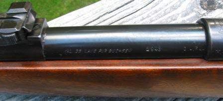

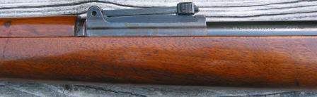

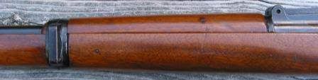

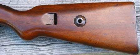

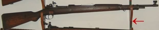

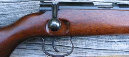

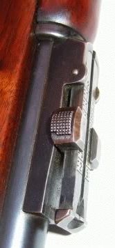

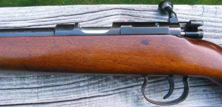

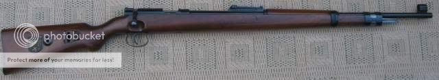

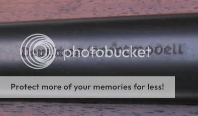

All of these pics are found in a rush on the internet.
Bellow are pics of one of these DSM 34. I chose Geco, as one of my favourites.
Geco stands for Gustaf Genshow Co.
Please pay attention to the action and receiver.
In 1939 or about, Mauser came with another series of trainers, the KKW.
These all had bayo lugs and detachable magazines.
Also, everybody agrees (including the milsurp experts)
that its production ended in 1939, when the war starts.
This bellow is known on the North-Am market
as the so-called “Kriegsmarine model”,
probably because it was stolen by american troops
from a Kriegsmarine cadet school or something like that.
Again, please observe the action and receiver.
This one is an example of the controversial ES340N. (“Controversial” as in
“the self entitled milsurp people are puzzled and do not agree upon its purpose”).
Was it used as a trainer or what?
The one bellow is called “unusual” and “variety” by the same
self-named internet milsurp cognoscenti.
I know for a fact that this receiver shape
and the rear end of firing pin/striker was copied
on many other .22 “trainer” models.
Hungary, Yugoslavia, Spain, Romania are only a few from the many
who copied one or more of its features in 50’s thru 70’s.
